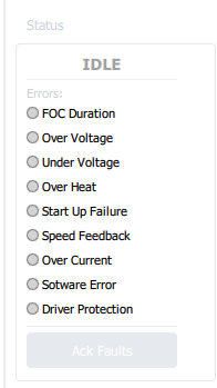

Please re start from a clean project in the motor control work bench and upload the generated firmware on the board. Then open the Motor Pilot from the drop down list as shown below.
STMCWB-Tools-menù.pngAfter connecting the board you can start your motor.
Please report the error that is eventually shown in the panel below.

could you please try to spin the motor using the motor control pilot software?
Check if any error is returned on motor start.

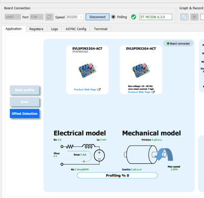

After successfully running the motor profiling tool the button now works as expected and starts/stops the motor.  What's interesting is that yesterday I ran the motor profiling tool and the motor spun, but the tool got stuck at 28%.  Now today the Profiling tool ran (after several attempts) successfully to 100% completion. And now the button seems to work to make the motor spin as expected.
However, after power-cycling the mcu the button no longer works to spin the motor.  Does that mean the profiler tool sends some parameters to the MCU that it needs to spin the motor?  Can I set those parameters somewhere in firmware myself and not require profiling?

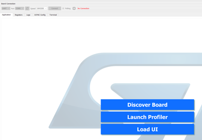

The Motor Profile tool will not connect to the debugger
But the Motor Profile tool connects right away:
But either way I don't want to run the motor through the Pilot program, I just want the firmware to boot up and spin the motor when I press the button. This currently takes me to successfully run the motor profiler in order to have the button work.  I've also tried a basic ramp command from boot and the motor makes a slight buzz before doing nothing:
