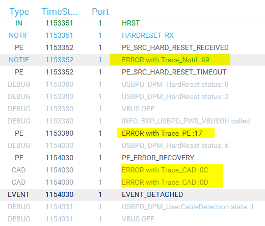

lately I realized that there are tracer errors from the USB-C stack in STM32CubeMonitor. I haven't seen them with older version of the USBPD libraries.
Currently I'm using:
- FW pack STM32Cube_FW_G0_V1.5.1
- USBPD core library is now V4.0.0
- USBPD device library is now V3.3.1
Where do these errors come from?
Thanks!
BR, Christoph

‎2022-06-24 12:28 AM
Hello @Christoph Rüdisser​
I don't have issues on my side, but I'm using STM32CubeMonitor-UCPD 1.2.0.
What is your version ?
The parts of trace that you are missing are related to USBStack notifications, or ErrorRecovey CAD states.
Could you please share the .cpd file so that we can replay the trace on our side to try to see what is wrong ?
Wiki : The trace files are saved in c:\Users\%username%\AppData\Local\Temp\STM32CubeMonitor-UCPD\Acquisition\ with ".cpd" extension.
Thanks
Nicolas
‎2022-06-24 12:13 AM
Hi @Nicolas P​
Thanks for your fast response.
I have attached the cpd file, but I had to remove the filename extension (uploading a cpd file was not allowed).
I've connected and disconnected the STM32G071B-DISCO multiple times, selected different PDOs, initiated datarole swaps and hard resets. I think there is still a problem with hard resets, but I thought I should fix the tracing at first.
The trace contains several of the following errors:
- ERROR with Trace_Notif
- ERROR with Trace_PE
- ERROR with Trace_CAD
Thanks,
Christoph

‎2022-06-24 1:05 AM
Hi @Nicolas P​
I didn't realize that a new version of the CubeMonitor-UCPD is available. I was still using 1.1.1.
With 1.2.0 there are no error messages anymore.
Thanks for your help!
