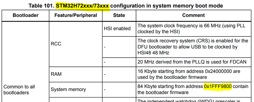

Why do all the IAP references for the H7 published by STM, show the wrong address?
Aqwer.1
I wasted many, many hours because the datasheet and app notes give the wrong boot address. For those of you that need to jump to the bootloader on the H7, use the following:
Which references?
This one seems right to me:
https://community.st.com/s/article/STM32H7-bootloader-jump-from-application
So does this one:
https://www.st.com/resource/en/application_note/cd00167594-stm32-microcontroller-system-memory-boot-mode-stmicroelectronics.pdf
Note that "system memory" and "boot address" are not interchangeable.
From the screenshot above:
> The system clock frequency is 66 MHz (using PLL clocked by the HSI)
This seems absurd. As the HSI has frequency of 64 MHz. While technically it can be done, I don't see a point of using a PLL to rise the system frequency to 66 MHz, which is almost the same. And it's not the case on other H7 sub-series either.
@Imen DAHMEN​ , @Amel NASRI​ , this should be checked and/or corrected.
