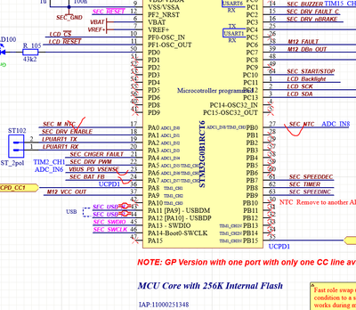

Hello Sirs,
I am developing a project, a portable device, which attached a 12.6 V battery pack. The device can be power on both the battery pack and a 100W PD adapter. There are a power management IC to organize and select the power path dynamically.
Right now, every works fine, except the orientation of the type C detection.
If attached the battery(not dead state), only one orientation works normally, i.o. out put 20V, another orientation only output 5V, that is the default PDO value. It seems only CC1 or CC2 can be detected.
But if i removed the battery pack, two orientation both works normally. CC1/CC2 can be detected clearly corresponding to each orientation which I changed, plug/ unplug with a different orientation for the type C.
My question is that when there are a battery(or battery pack) attached, is that dead battery signal must be enable? The problem What I met is related with the i have not enable the dead battery signal?
Could somebody have experience on this topic?
Thank you very much!
Matt

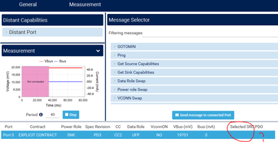

‎2023-11-03 2:24 AM
Hi Matt,
Enable or not Dead Battery does not impact cable orientation.
Best regards,
Mathieu

There are no info. for "Selected SRC PDO" , your can see every thing is ok now. Could you please tell me where misss a trace print code? I will correct.
Thanks,
Matt
‎2023-11-06 2:25 AM
@Lmatt.11 If you start UCPD monitor after the capability messages are sent, you will not have all details.
Could you share the .cpd file ?
Have you solved your orientation problem ? If yes, can you share for other forum visitors please ?
Regards,
Nicolas
‎2023-11-06 5:02 AM
Hello Matt,
Your comment is fair because selected PDO is no more displayed since last STM32CubeMonitor-UCPD version (under update).
You can find all useful information for the Power Delivery negotiation on trace as shown on left trace.
Best regards,
Mathieu

I have also some questions about the dead battery for CC1/CC2. In my project, there are a battery pack to previde the power for system, this PD type C can be attached to charge the battery, or both chargeing and previde power for thw system(portable device).
My question are,
1. Is it better to set the daed battery for CC1/CC2? Because the battery maybe dead and under this condiation we have to charge by PD.
2, If no dead battery for CC1/CC2, what will be happened hwne battery is dead? PD can't be negotiated successfully for there are no power supply for CC lines?
3, I saw some engineers short the CCxDB and CCx lines togather, is this a right connection?
Thanks,
Matt
‎2023-11-09 7:51 AM
1- It is not necessary to activate DB in STM32G0 because they are already embedded in TCPP01-M12.
2- DB allows 5V Vbus turn-on when fully depleted battery or system powered only by Vbus. Once, dead batteries resistor detected by the SOURCE, it turns on 5V on Vbus and the SINK can be powered by 5V. Next, a Power Delivery negociation can be done. TCPP01-M12 embeeds DB then process to reach 20V negotiation can be archived.
3- CCxDB connection to CCx lines is mandatory to activate by HW DB on STM32. TCPP01-M12 embeeds DB. This short is useless with TCPP01-M12. 2 STM32G0 PIN can be saved.
