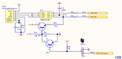

I am trying to debug my vcp application (uses STM32F103CBT6), but when I start a debug session the COM port does not work. When not debugging, just uploading a new code, the cdc communication only works after a power reset. I modified my custom board: added transistors to the DP pull up resistor to be able to disconnect it from 3v3 with code, but it does work, it won't reenumerate the device.
When debugging, CDC_Control_FS() never get called.

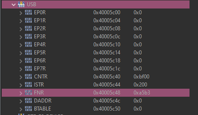

The USB variables when the communication is not working:
and the registers:

‎2024-05-26 9:20 AM
I have used USB with the following method before.
By directly connecting the dp pull up resistor to an IO,
When the device is reset, set the dp pull up resistor to 0.
I set the output to 1 just before the USB setup function.
here is part of my schematic

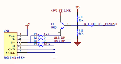

BTW first I tried what ST uses in their schematic:
but this did not work at all.

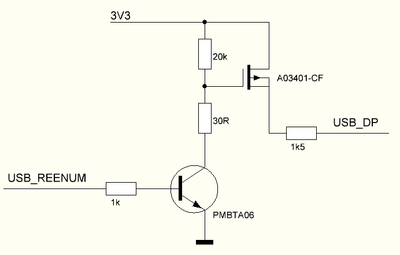

Then I built what I thought will work:
and this is working in normal case, but not in debug case.

Would you please tell me where you found the implementation?
I'm suspecting a mismatch with the current implementation on F103 eval board.
‎2024-05-30 1:16 AM
Oookay. I won't trust this much the internet next time. I just searched for stm32 f103 schematic.
