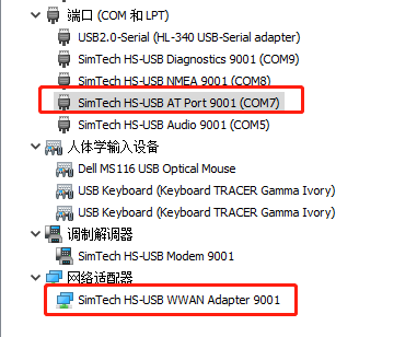

i have a slave device(SIMcom LTE) which needs more than two interfaces USB serial and USB RMnet
i dont know whether f407 support it? meanwhile i want to do it on RTEMS

simcom device in windows
This device is part of a composite device.
Connection Information
 Port: 1
 Speed: High Speed (USB 2.0)
 Device address: 6
 Open pipes: 17
 Connection status: Device connected

doing it with stm32 is worthy?
Pavel A.
The host (aka OTG) controller of STM32 supports only 16 endpoints. But this device wants 17.
Need to check if some endponts are not actually used.
-- pa
but i dont know how to do it
