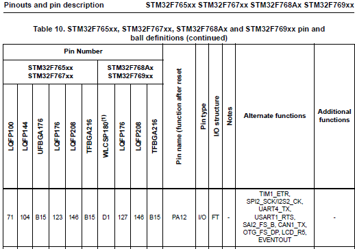

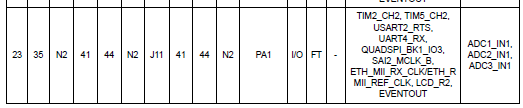

Coming from a STM32L4 world - PA1 looked a little unusual....Same in your part world.
PA12 maybe - Hopefully you just made a typo here

Sorry, PA1 was a typo. It's PA11 and PA12 as in the code.
