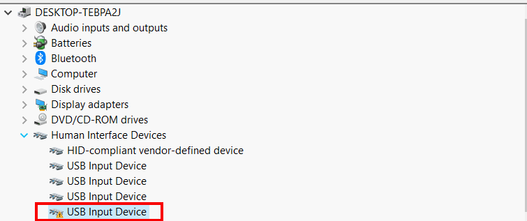

I follow this video to implement my USB HID Project https://www.youtube.com/watch?v=3JGRt3BFYrM&ab_channel=STMicroelectronics

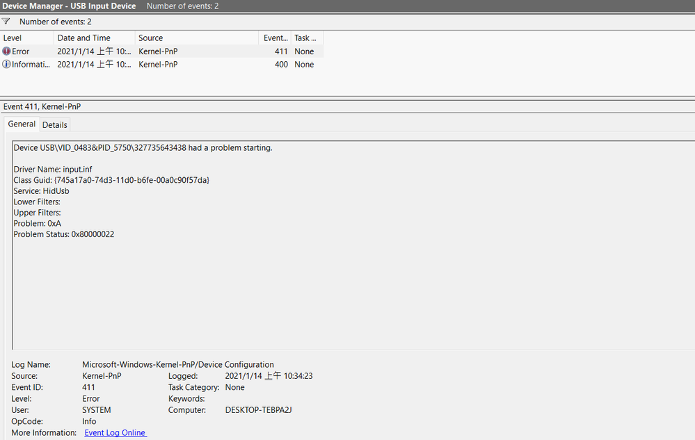

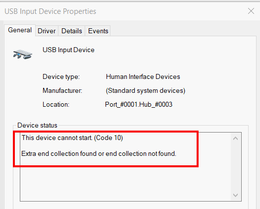

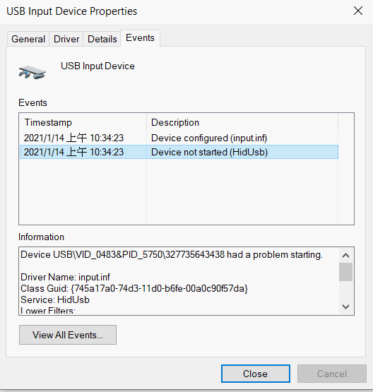

On the Win7, it work perfect, but when I use Win10 as PC Host, it cannot work
just like bellow picture
Please Help me to fix this issue :downcast_face_with_sweat:
thanks

Hello @TWu.5​ ,
I advise you to follow this article: USB device not recognized with the solution to either increase the heap size, or configure the USB library.
Hope that this brings some help.

Thanks for the reply and help,
I try to close the ​compiler optimization level , and host can recognize the device
