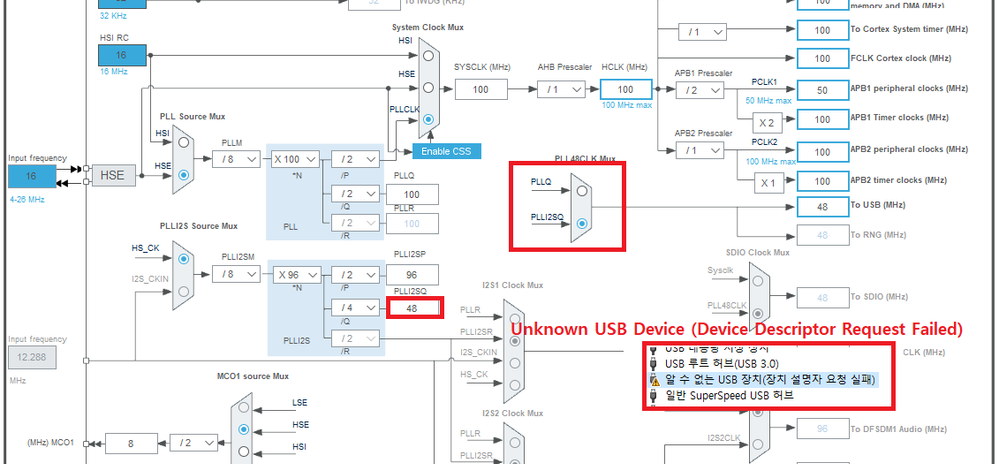

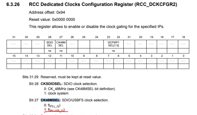

USB Clock Not surport PLLI2SQ? (STM32F412RE)
KMin .1
hello!

Hello!

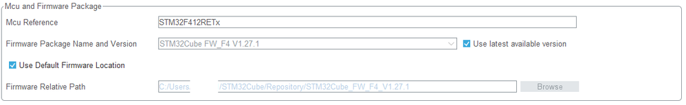

FW version
0693W00000Y9Z9RQAV.pngUSB Device_Only mode. (Virtual Port Com)

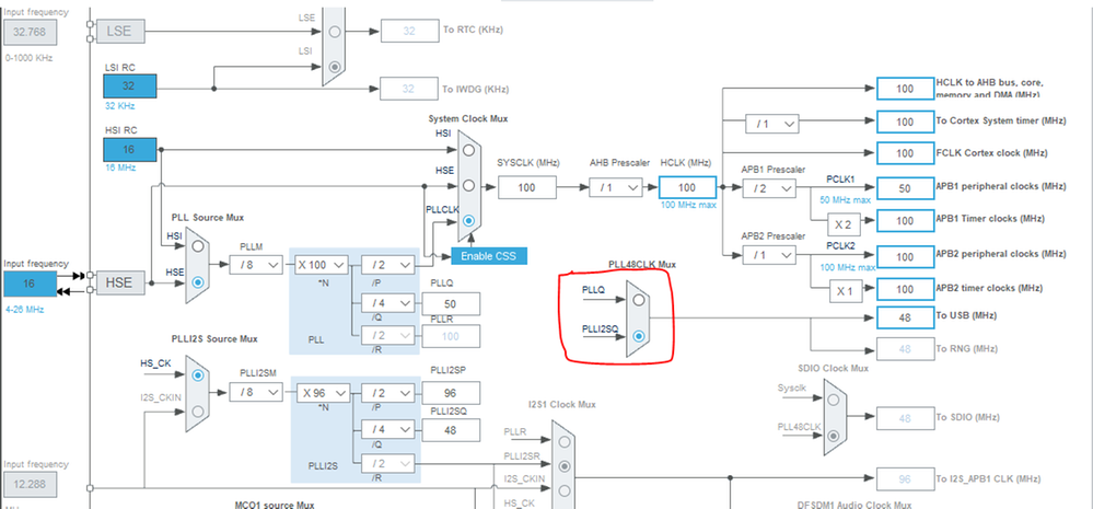

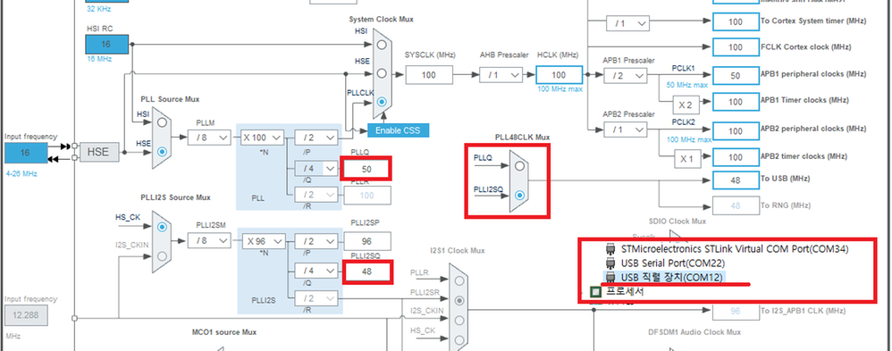

Select PLLI2SQ clock.
Unknown USB Device (Device Descriptor Request Failed)
Not Setting PLL48CLK Mux ?​ PLLQ 50Mhz?

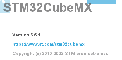

Hi.
STM32CubeMX Version is 6.6.10693W00000Y9oY7QAJ.pngAttach ioc file.
Hi @KMin .1​,
Your project is successfully worked for me (using STM32CubeMX 6.7 and STM32Cube_FW_F4_V1.27.1)
Please make sure to follow this article USB device not recognized, with the solution is to either increase the heap size or configure the USB library to use static allocation.
Check if the USB_OTG_FS_DP and USB_OTG_FS_DM wires are swapped.
Check if you have this driver installed properly!

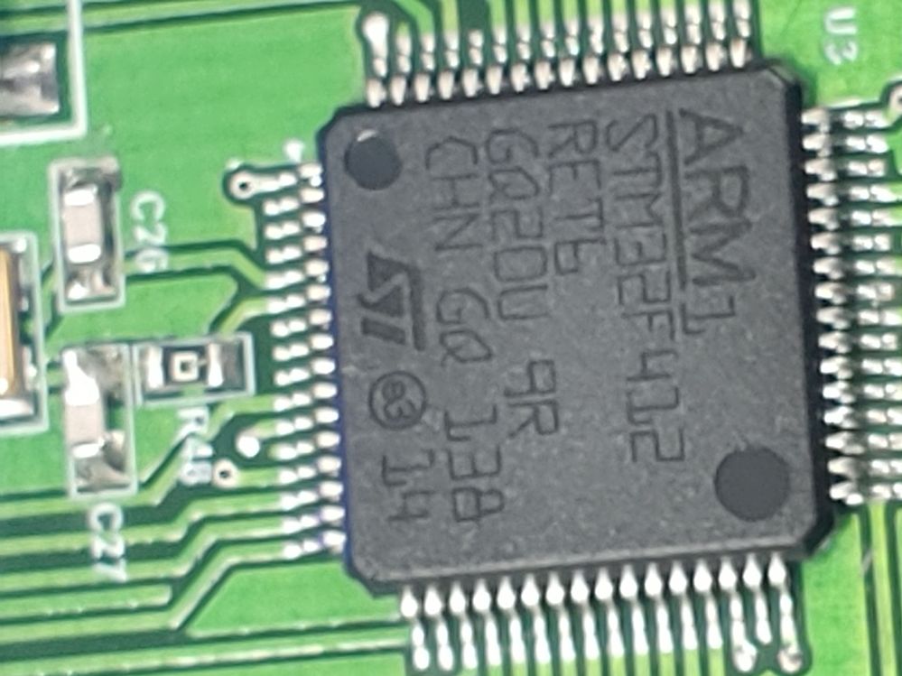

Hi.
Can you confirm that the chip is genuine?
