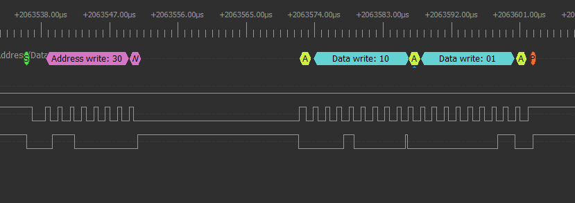

I have a STM32F030C6 on a custom board and I want to use it as an I2C slave device.
With the example given with the cube hal (FW 1.9) I got it working. Kind of.
I can write data from the master to the slave. But I have problems reading data from the device.
I also used this example I found online, because it is mostly what I want
https://github.com/cnoviello/mastering-stm32/blob/master/nucleo-f030R8/src/ch14/main-ex2.c
What I got now is this:

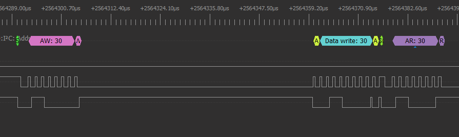

Using a master device to write to register GLOBAL_GO works perfectly. But reading Register GAME_POINTS causes the thing to be stuck in Line 11 of the code above with State HAL_I2C_STATE_LISTEN
This causes clock stretching to keep SCL low and everything comes to a halt. Is there a resource where it is shown how read and write is done? Or do I simply miss a little information?
I attached a trace of a working write
and a not working read

2019-04-02 11:21 PM
I used byte wise transfers and they work. To bad HAL does not clearly statzes how to do sequential transfers correctly.
