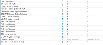

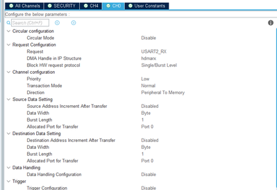

hi, I am using stm32U5's uasrt2 DMA RX ,  DMA interrupt coming, usart idle int coming, ROR value right, but rx_buffer was not refreshed by DMA, here is my part of code.

I connect usart2 TX and RX pin to do the test , the RX value should be  equal to TX, I have no idea what is wrong ....

-I also recommend enabling the destination address increment.

thanks a lot , it really was caused by
  MX_GTZC_Init();
I used memory management tool in MX which set the GTZC enable
Thanks !!!
