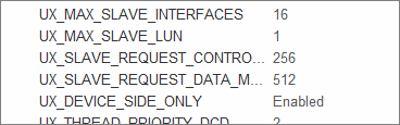

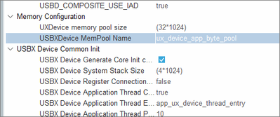

Are you sure about UX_DEVICE_APP_MEM_POOL_SIZE? It should not exceed total size of available memory. Also have you tried the example from cube firmware without changes in the config and HW setup?
2024-01-25 12:54 PM
I had to reduce the UX_Slave_Request_Data_memory to 512 from 2048 to avoid crashing, even though I increased the UX Device mempool size to 32K in an attempt to stop crashing when using 2048, which did not resolve. The demo code uses 16K and 512.
In the code:
#define USE_STATIC_ALLOCATION 1
#define TX_APP_MEM_POOL_SIZE 1024
#define UX_DEVICE_APP_MEM_POOL_SIZE 32768
#define USBPD_DEVICE_APP_MEM_POOL_SIZE 5000
I checked the byte pool memory, and it reported no error. I'm familiar with Azure ThreadX.
PS: I have attached the IOC file from the previous comment.

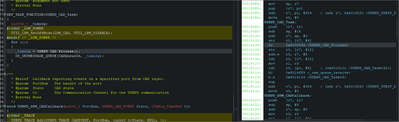

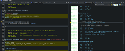

2024-01-26 11:49 AM - edited 2024-01-26 11:50 AM
The above is the working demo code (2021) with a breakpoint to check USBPD_CAD_Process(); I found no source code for this function. The callback is working fine.
Below is the issue code (2024) with the same breakpoint as above; the callback is implemented but not run. I don't know what is happening in USBPD_CAD_Process() or why it is not calling a callback. The callback was implemented by the init code (from CubeMX), and the demo code was copied (2021).
Because I don't know what in USBPD_CAD_Process(), do they run callback? what makes it work for the callback code to be executed?
