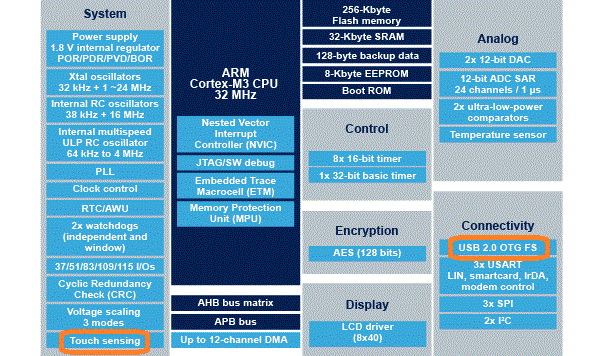

Has anyone used the STM32L series USB in host mode?
I'm looking at this part at design-in stage. I need the Capsense feature but I also need to use USB in host mode to support optional WiFi.. The ''circuit diagram'' on the website says it has USB OTG FS but I can see no reference in the specs.
Thanks

As far as I'm aware the STM32L15x series didn't support USB FS OTG
http://www.st.com/st-web-ui/static/active/en/resource/technical/document/application_note/DM000329pdf
What about the
http://www.st.com/web/en/catalog/mmc/FM141/SC1169/SS1295/LN1808/PF255680
? The diagram does say OTG, but the docs/sw don't seem to support it. Will push to moderation.

Hi Clive1,
I confirm; STM32L1 doesn't support USB OTG FS. This includes STM32L100.
Thanks for your relevant feedbacks Clive1, issue with web diagrams will be fixed soon.

Thanks All, I suspected as much. Copy and Paste error!
OK, I am resigned to using SPI to interface the Ethernet. Initially looked at the ENC28J60 from Microchip but the W5500 from Wiznet looks more interesting, it integrates the TCP-IP stack which looks like it would make the software dev much easier.
