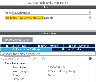

AScha.3
Obviously you set something wrong ..in clock tree, or uart setting.
see:
If the baud rate is not what you want, it is not configured correctly.
