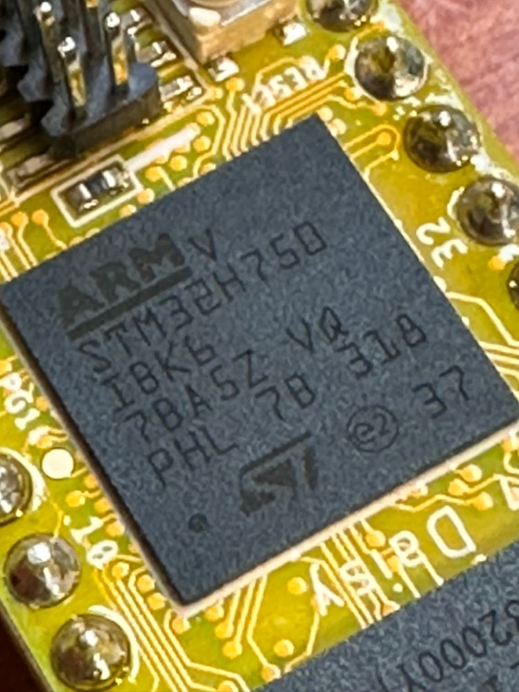

Hi, We've been using a board (the Daisy Seed) that has an STM32H750IB and external QSPI flash chip.
We're having an issue with some of the boards somehow getting into a persistent (across reset. power cycle, and chip erase) state whereby the SCB_EnableDCache function is taking several seconds to execute. Even stranger, when DCaching is disabled, then the QSPI init call takes several seconds. Most of the boards are working fine, but somehow something happens and the board/chip will start doing this. In one case, it just as randomly stopped doing it.
Could some kind of un-initialized variable be causing this?
Also, we're using an older version of CMSIS code (Ver 5.0.1), has anything been fixed or changed in the newer versions?

My primary concern would be with the VCAP capacitors, either one 4u7 or a pair or 2u2
Inadequate, low ESR, capacitance here is the source of a lot of quirky behaviour

‎2024-07-05 11:39 PM
What you think...? :)
‎2024-07-08 1:09 PM
Looks like a 'V'

Odd behaviour tends to be power related, or with Internal Flash timing. If clocks don't start things can be relatively slow. The H7 starts on a 64MHz HSI, you can continue to use that without doing anything, and output via a serial port to understand internal state and progress.
Should see 1.25 V on the + side of the VCAP's, you could perhaps look at supply stability there, and the 3.3V rails.
