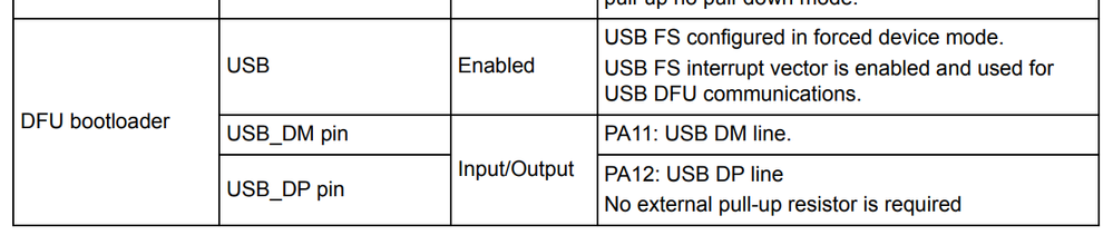

Looks like the USB connector on that board is using the HS USB which is not supported by the STM32 bootloader.

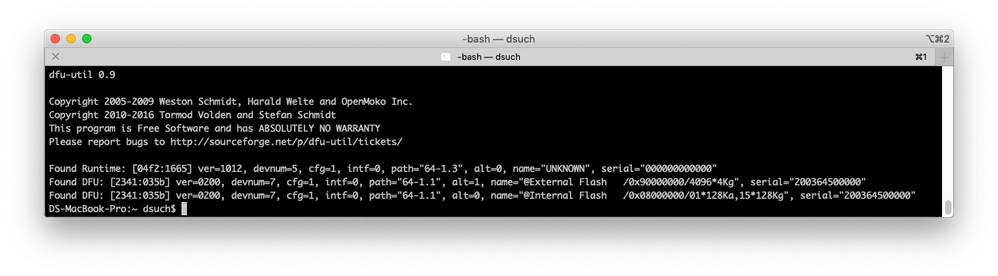

Hi TDK, we are working on porting BetaFlight (drone flight control firmware) to the Portenta. BetaFlight Configurator can detect when an attached board is in DFU mode. To double check this I also opened up the STM32CubeProgrammer, and it can't detect any attached boards in DFU mode either. The only way that I can upload code at the moment is via the Arduino bootloader (which uses dfu-util ironically). There is not much debug capability built into the Arduino IDE.
I tried dfu-util as well. In the Arduino bootloader I can see two DFU mode devices listed for the Portenta (internal and external flash). When I jump to system memory using the address in the ST suggested code the mbed OS crashes (indicated by the RGB LED flashing a red SOS).0693W000003OmveQAC.png
Thanks TDK - you were on the right track. The Portenta can do both HS and FS USB however Arduino devices have a proprietary USB VID/PID. This was the problem. All we needed to do was modify the BetaFlight Configurator source to recognise the VID and PID. I appreciate your assistance and the time spent looking into our problem.
