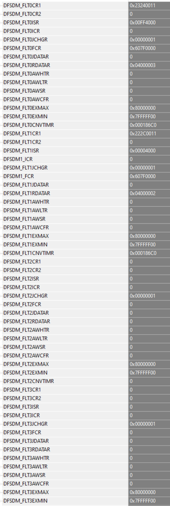

Board: STM32H747I-DISO
SDK: STM32Cube_FW_H7_V1.6.0
Pin: PD3(CLK), PC7(DATAIN3)

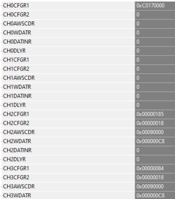

Problem: Filter->DMA bufer OK. HAL_DFSDM_FilterRegConvCpltCallback and HAL_DFSDM_FilterRegConvHalfCpltCallback function enter normally, but the data is wrong(always the same number).
I monitor the DFSDM registers, the RDATAR register no change.

1 REPLY 1
IFaye.1
Hello, @zjiaz.1​ ,
Do you figure out this issue? I face the same problem and i see around that many others have troubles but there is no answer for now.
I layed my work on stm32h747-eval DFSDM example and i tailored it for my stm32h747i-disco but my left and rightbuf always be filled by same value -16777216 and so when they in SaturaLH the play buf is filled by -32768. So I supposed that it about error configuration on DFSDM init. Is someone can please bring us response?
Thanks,
