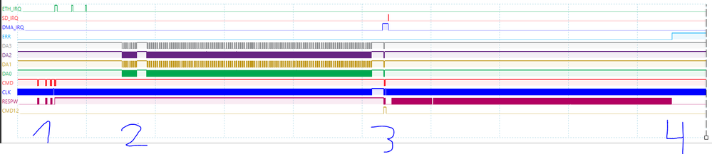

Hello all,
I have worked through a number of issues with the SDMMC system and am currently stuck with not being able to reliably transfer from micro SD. I wrote test code to repeatedly read a file from the external card. In some cases HAL_SD_ErrorCallback is called with error code SDMMC_ERROR_CMD_CRC_FAIL.
Here are some things I have tried:
1) Slowing down the clock speed
2) Redesigning the board to improve the signal integrity of the micro SD lines
3) Using SDMMC2 instead of SDMMC1
4) Using 1-bit mode
5) Upgrading to Cube 1.3
6) Switching the pullup mode on the pins on and off
Here is a code excerpt:

Any ideas? Thank you very much.
UPDATE: I am using FreeRTOS and followed the FatFs_uSD_DMA_RTOS sample.

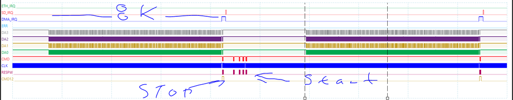

I tested this one change (without taking all of the V1.4.0 update) and all of my DMA-based reads now time out. I am still tracking down why...
It seems to work correctly for retrieving CSD, etc, but not for doing Multi-block DMA reads
The SDMMC_FLAG_CMDACT bit never goes low, when I do a DMA-based single or multi-block read, so it always exits the while loop with a timeout.
Is there something else required?
AHigg
This change ultimately proved to be the answer:
uint32_t SDMMC_CmdReadMultiBlock(SDMMC_TypeDef *SDMMCx, uint32_t ReadAdd)
  uint32_t maskReg = SDMMCx->MASK;
  SDMMCx->MASK = 0;
  SDMMC_CmdInitTypeDef  sdmmc_cmdinit;
  uint32_t errorstate;
  /* Set Block Size for Card */
  sdmmc_cmdinit.Argument         = (uint32_t)ReadAdd;
  sdmmc_cmdinit.CmdIndex         = SDMMC_CMD_READ_MULT_BLOCK;
  sdmmc_cmdinit.Response         = SDMMC_RESPONSE_SHORT;
  sdmmc_cmdinit.WaitForInterrupt = SDMMC_WAIT_NO;
  sdmmc_cmdinit.CPSM             = SDMMC_CPSM_ENABLE;
  (void)SDMMC_SendCommand(SDMMCx, &sdmmc_cmdinit);
  /* Check for error conditions */
  errorstate = SDMMC_GetCmdResp1(SDMMCx, SDMMC_CMD_READ_MULT_BLOCK, SDMMC_CMDTIMEOUT);
  SDMMCx->MASK = maskReg;
  return errorstate;

Hi Aaron,
I don't think your solution will work if DMA is used. It looks like you are disabling all interrupts by setting the MASKR register to all 0's.
In my case, CRC problem isn't really a CRC problem. In the call to GetCMDResp1, the following call fails:
 /* Check response received is of desired command */
  if((response_r1 = SDMMC_GetCommandResponse(SDMMCx)) != SD_CMD)
	  DBGprintf("cmd sent: %x response: %x\n", SD_CMD, response_r1);
    return SDMMC_ERROR_CMD_CRC_FAIL;
In my case, the command (SD_CMD) is 0x10 to set the block length and the response returned is 0x0d. The function does return the SDMMC_ERROR_CMD_CRC_FAIL error, but it is really a command request/response mismatch.
If I put an ITM trace call in the main GetCMDResp1() call, the CRC problem also goes away, which points to a timing issue.
...Keith

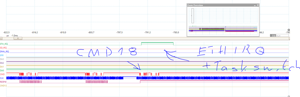

Garnett.Robert
Senior III
Hi All,
I've been having trouble with CMD CRC errors with multi block writes. (I don't do much reading as I am logging data into an sqlite db. The error is infrequent and seems random. it occurs in the following part of the sd card driver:
  * @brief  Send the Write Multi Block command and check the response
  * @param  SDMMCx: Pointer to SDMMC register base
  * @retval HAL status
uint32_t SDMMC_CmdWriteMultiBlock(SDMMC_TypeDef *SDMMCx, uint32_t WriteAdd)
  sdmmc_cmdinit.Argument         = (uint32_t)WriteAdd;
  sdmmc_cmdinit.CmdIndex         = SDMMC_CMD_WRITE_MULT_BLOCK;
  errorstate = SDMMC_GetCmdResp1(SDMMCx, SDMMC_CMD_WRITE_MULT_BLOCK, SDMMC_CMDTIMEOUT);
  seggerError(5, errorstate, sdmmc_cmdinit);
  return errorstate;
I have looked at the sd card bus signals and they look fine.
Arron, how does the mod you made fix the problem and do you think it would work for block writes as well as block reads.
I am thinking of giving it a try, but I would like to understand what it is doing.

Garnett.Robert
Senior III
Hi All
I tried out Arron's "turn off SDMMC controller interrupts" patch for the SD Card erros. I put his patch in the write/read multiple blocks functions and it has worked.

I’m adding this here as I think this is belonging to the same issue but regarding STM32F7 family
The problem I see is about the combination of RTOS, SDMMC, FATFS and DMA
I’m currently working on code development for a new product based on STM32F769. At the moment I’m using STM32F769 Discovery kit as development hardware. I’m using FreeRTOS and FATFS. As data drive I use a standard SD card which is using SDMMC2 in SD 4 bits wide bus mode with a clock frequency of 24MHz. Transfer mode is DMA. I was able to manage through all the problems with DMA, CACHE, MMU and the code seemed to work quite stable. For testing, I’m using a test task which permanently reads a 140MB size file from the SD card (reading in 8kByte chunks). For better understanding I added a shot of successful card reading signals. Top three channels show some IRQs, ERR is indicating a timeout in SDMMC_GetCmdResp1, the signals on the SDCARD (D0-3,CMD,CLK), RESPW toggles while waiting in SDMMC_GetCmdResp1 (also when leaving) and CMD12 which indicates the stop command. (200us/diff)
 0693W00000Hq5WdQAJ.pngIn my next step I added LWIP to the project and created a task allowing me to do some TCP communication. Now, when sending data on the TCP channel, after some time, I get low level disk I/O errors. The more and faster I sent, the earlier the errors occur.
I did some investigation on that issue and tracked the problem down to SDMMC_GetCmdResp1. Here the code is running into a timeout. I did some hard debugging to figure out to get more info about it. I think I found the following:
0693W00000Hq5XMQAZ.png1.)   After the ending of previous 8k read the next read multiple block command (CMD18) is sent to the card and wait for the response. Below picture show the zoom of the start.
While handling the CMD18 response an IRQ of the Ethernet is occurring. The toggling of RESPW stops although the response is not even received (in above zoom it is setting RESPW to high). Reason for that is that the Ethernet IRQ is serviced (is fine). However, with the IRQ the scheduler also seems do a task switch. The task for the SD card seems to get suspended.
2.)   The data transfer starts and DMA is handling this. SD card task still seems to be suspended.
3.)   The data transfer is complete, DMA IRQ handles the stop command and overwrites by that the contents of the SDMMC_STA register. Short time after the SD_IRQ is handled the SD card task is getting back context and continues. However, as SDMMC_STA was modified by the DMA IRQ the SD card task never sees the result of sending the command.
4.)   SDMMC_GetCmdResp1 runs into timeout
I haven't tried the patch by now but I thought it should be in the STM32F7 firmware package.
For test purpose I tried vTaskSuspendAll() and xTaskResumeAll() to avoid tasks switching between sending the command and the receive. This removed the the disk IO errors. However, I doubt this is a clean solution.
