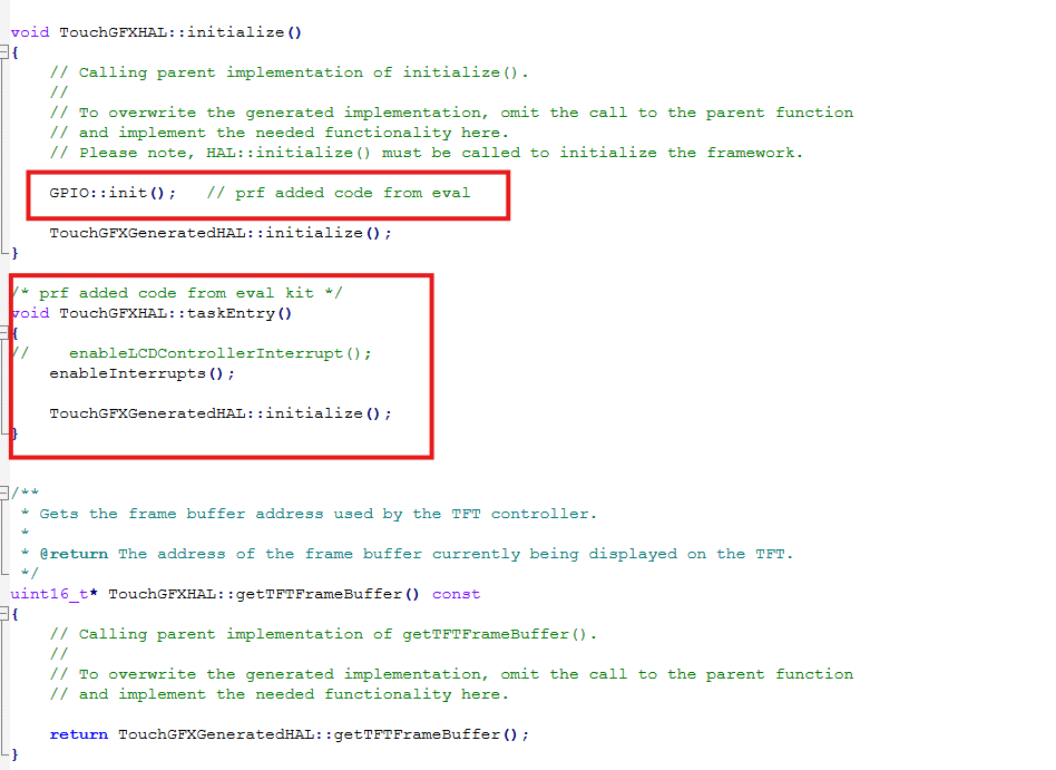

I noticed that none of my tasks were running and I did have a defaultTask previously running that toggled a pin so I could see a "heartbeat" of the system.
In the debugger when I paused execution I noticed the trace buffer showed it was entering prvTaskExitError after the osKernelStart() was called.  Apparently while I was comparing my TouchGFXHAL.cpp with another application that used TouchGFX and an LTDC interface to the display I was copying over things to see if it would help the problems I has having with the SPI TouchGFX interface and left a few things in there inadvertently...once this was removed the RTOS started running correctly.

Yes, once I removed the code above and added a task to call the signalVSync() functions at the appropriate interval then the TouchGFX interface worked for single framebuffer.
