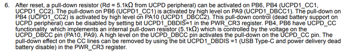

It looks like there is a pull-down resistor configured on these pins, and according to the DS, these pull-down resistors are controlled by the level on PA9 and PA10:

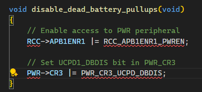

I've tried to disable these before GPIO init, but it did not work:
Any recommendations on how to properly disable these internal pull-down resistors on PB4 and PB6?
