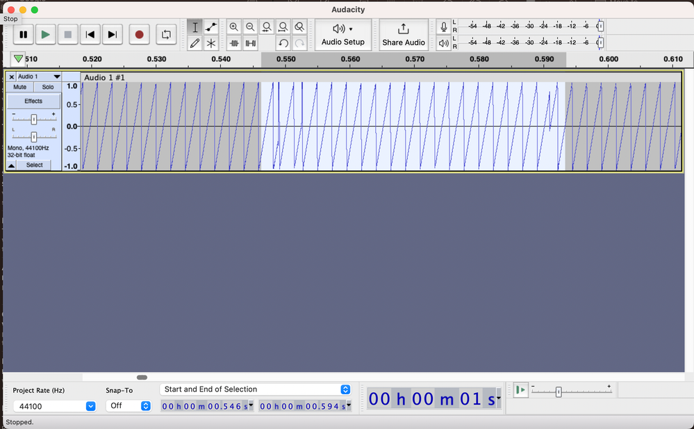

I'm stuck. I'm able to send a 440 Hz sawtooth wave to output over USB from Nucleo board (device) to my computer (host).
The only problem is, there's this repetitive clicking / choppy sound in the resulting audio when I record with Audacity. The click happens relatively regularly, like 1.3x per second.
Another issue, I'm not sure if it's related or not: When I sweep the frequency from 440Hz to 880 Hz using a potentiometer, I can audibly hear the sweep happening twice. It's like USB is caching or reusing some buffer or something. (Tried to link code and audio examples but it's restricted because I'm a new member)
Maybe there's some clock issue? I think I read somewhere that the Nucleo's built-in crystal oscillator (8MHz) may not be suitable for USB due to some out-of-sync issues with USB communication.

ECLEW.1
After reading more about USB audio streaming (in particular, 1.) UM2195 User manual USB device audio streaming Expansion Package for STM32Cube and 2.) Universal Serial Bus
Specification)
it sounds like clock drift isn't something that can be cured simply by using the most accurate clock, because there will always be a minuscule amount of drift.
It sounds like there are three ways to alleviate clock drift: asynchronous, synchronous, and adaptive.
I've tried setting bmAttributes as synchronous, but that didn't help.
Maybe I need to use the same epType (same bmAttributes) in my call to USBD_LL_OpenEP.
Or maybe there is something else I need to be doing.
ECLEW.1
One thing I noticed is I'm only calling USBD_LL_Transmit 333.3 times per second, as opposed to matching the SOF trigger at 1000 times per second.
My SOF handler function is being triggered 1000 times per second, but I have some transmission logic that reduces the amount of times that I actually call USBD_LL_Transmit to 333.3 times per second...
Actually, I got this throttling logic code directly from ST: X-CUBE-USB-AUDIO
ACTIVE STM32 USB Device Audio Streaming software expansion for STM32Cube. I don't understand the meaning behind a 1000/3 times per second execution schedule.
I'm wondering if the throttling logic might be the problem, so I tried bypassing the throttling logic and calling USBD_LL_Transmit 1000 times per second instead, but it resulted in strange behavior, namely, the audio would come out really condensed, followed by silence. It's as if the sample rate was not correct, because the resulting audio was a few frequencies higher than expected.

So I sort of figured out what was going wrong.
Although my SOF callback was getting called every 1ms, USB was really only ready for data transmission every 3ms (the reason for this I'm still not sure, what would like to find out at some point).
So rather than Transmitting 1ms of audio data per transmission, I needed to Transmit 3ms of audio data.
So I just multiplied the size of my buffer by 3, and now it works.
I noticed there's a considerable latency between the MCU and monitoring through my DAW. I've experienced this with other audio devices (e.g. Roland boutique synthesizers has audio over USB). Perhaps they had a latency in the scale of 10s or 100s of milliseconds. I'm guessing they use High Speed USB instead of Full Speed. I'm just guessing because I just started using a USB monitoring app and saw that my FocusRite Scarlett uses High Speed USB. Perhaps High Speed USB is the way to go.
The audio is also not perfect. It's has a couple clicks here or there. Nothing like the repetitive, consistent 1.1hz clicks I was experiencing though. Maybe if I increase my buffer size and slow down the SOF interval (if that's possible), it will sound clearer.
