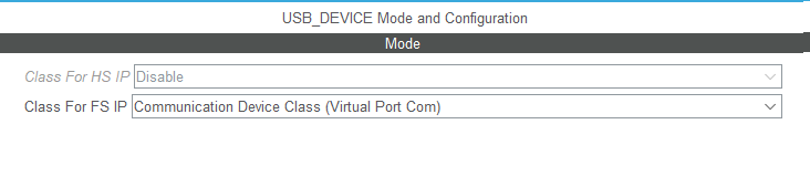

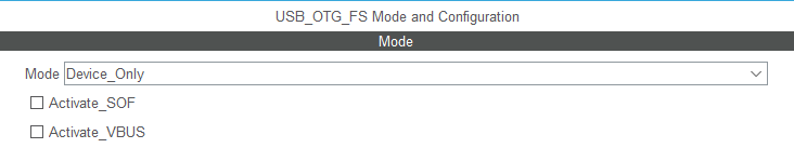

I am using a STM32F429I-Disc1 board and configured my project as follows:
USB_OT_FS:
0693W000007Bk2SQAS.pngUSB_DEVICE (middleware):

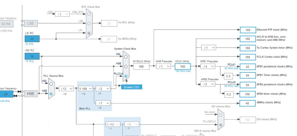

0693W000007Bk2XQAS.pngAll parameter settings are default and nothing has been changed. I also increased the minimum heap and stack size for the project :
0693W000007Bk2cQAC.pngClock config:

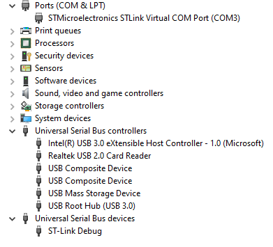

However when look for my board in Windows Device Manager it is nowhere to be found:
0693W000007Bk3LQAS.pngOnly the STLink debugger VCOM is detected and I am running out of options here.

Unfortunately Windows still does not see a second Virtual Com Port except for the standard STLink debugger.
I have seen on different forums that people with this particular board have the same troubles I am experiencing (Windows 10 not recognizing the port).
Maybe the problem lies somewhere else?
