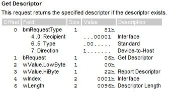

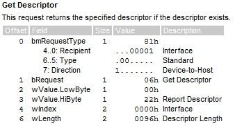

Analyzing USB setup sequence by USBlyzer i found out that wIndex field is responsible for selecting current interface. So my host generates two different requests with wIndex = 0 and wIndex = 1:
0693W000007BYxRQAW.jpg0693W000007BYxWQAW.jpgI also have modified the code to manage these indexes during class data setup:
