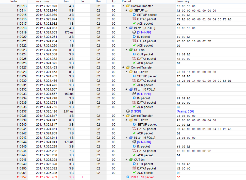

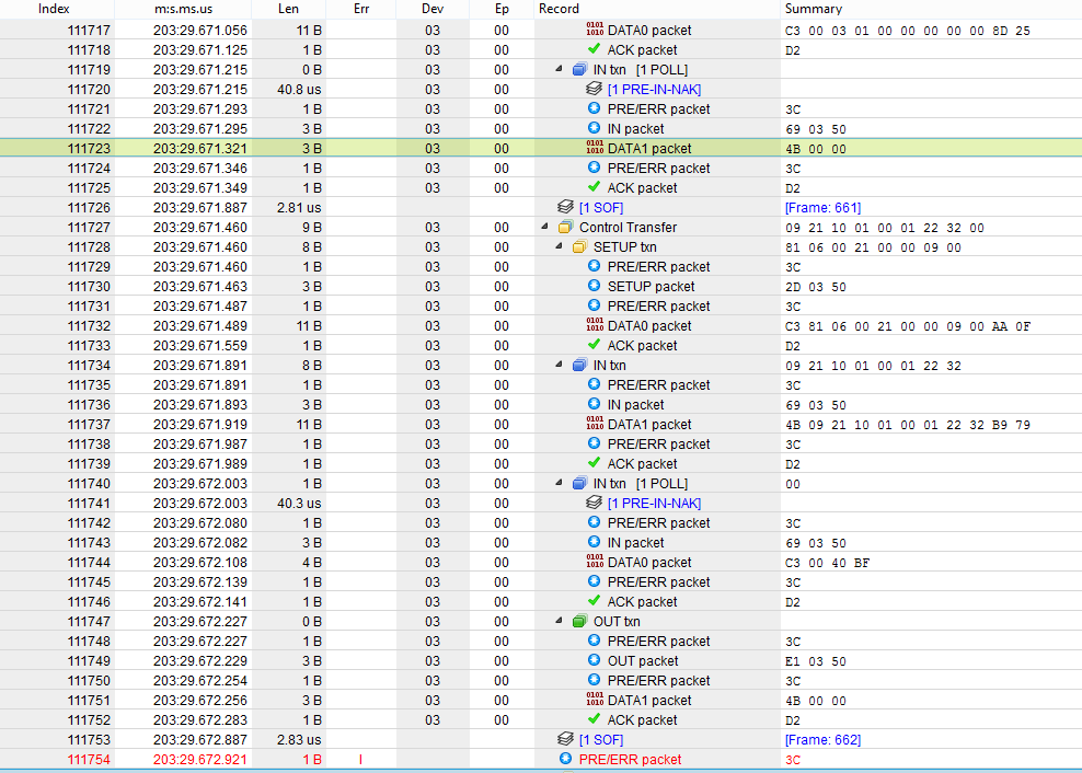

I managed to get my Hands on a beagle 12 USB Protocol Analyser. I was able to catch the Error with this very useful tool:
one picture shows the error after the first Pre PID was send. The other pictures shows the error a bit later after a few successful transfers. But everytime the PRE PID is the last information send by the Host before the Host gets shut down completly. There are no SOF or anything else coming from the Host..

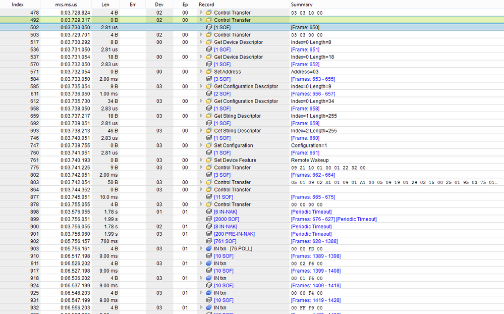

Well Jan, don't ask me why it is working sometimes. Looking at the trace of a successful enumeration shows no difference in timing compared to a failed enumeration: 0690X00000AR8A3QAL.png
(I'm connecting a low Speed Mouse over 2 HUBs with the STM32)
Because of the fact that I got it working sometimes I thought it might be a simple timing error. But this trace says a different thing to me.

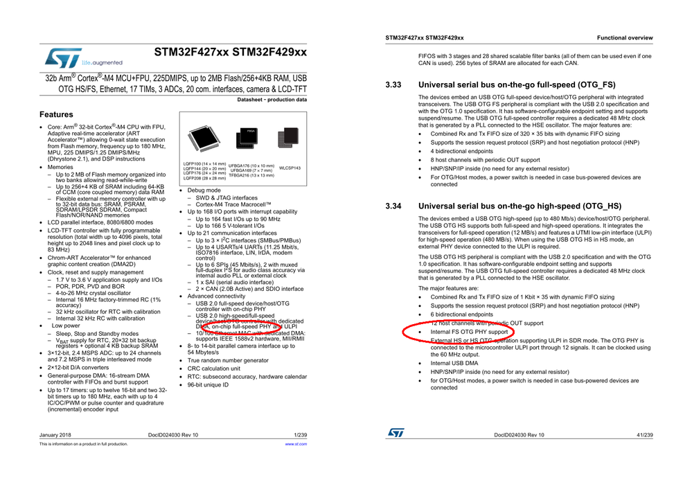

Question is, does the STM32F4 supports UTMI+ Level 3 or just Level 2? We were wondering because sometimes the High Speed hub works fine which should not be when the STM32F4 is only supporting UMI+ Level2. When STM32F4 does not Support the UTMI+ Level 3, which MCU could do this?

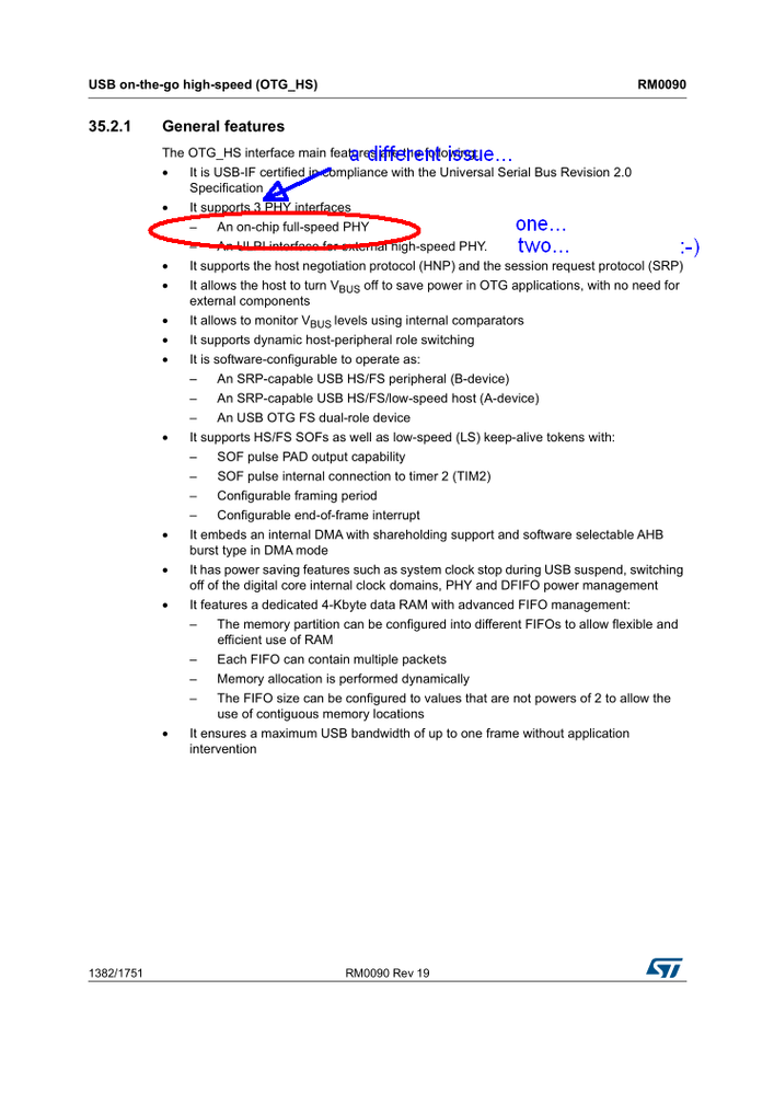

@Amel NASRI​ , this erratum for the OTG_HS does not specify, if the problem occurs only when using the built-in FS PHY (which is IMO the case) or also with external ULPI HS PHY. Can this please be clarified. And can please this erratum be propagated to errata for all devices which are affected. Thanks.

I don't like the formulation, what is "full-speed interface", is it the internal FS PHY or external ULPI PHY In FS mode?
What's wrong with calling the internal FS PHY... well... internal FS PHY?
Errata should be unambiguous and should use terminology introduced in DS/RM:
The naming and description of OTG modules and especially this detail (i.e. presence/usage of internal FS PHY), while fairly well described in 'F4 materials, is very badly treated across other STM32 families (I've complained in the past, but honestly have no energy to look it up nor summarize it again). Please don't make it worse in the Errata.
