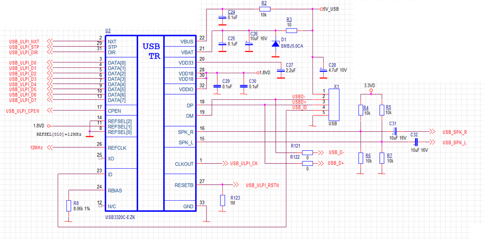

Hi colleagues!
I suppose this is old topic, but I haven't found the solution yet.
what I have:
1. Modified STM32F4_discovery: removed microphone, and some resistors for avoiding conflict with ULPI interface.
2. Board with USB3320, which connected by connectors.
Scheme:
3. Modified project STM32_USB-Host-Device_Lib_V2.1.0\Project\USB_Device_Examples for my pins.
What I did wrong?
#ulpi #usb-hs #usb #3320

Posted on December 13, 2013 at 21:18
What I did wrong?
The most obvious one would be that the VDDIO is the voltage for the ULPI interface, and that's NOT 1.8V
zuew
Posted on December 16, 2013 at 05:46
Clive,
My MCU works with 1.8V logic level.
And VDDIO could be either 1.8V or 3.3V.
Posted on December 16, 2013 at 13:40
My MCU works with 1.8V logic level. And VDDIO could be either 1.8V or 3.3V.
So you modified the STM32F4-Discovery supply? The operating voltage specified for USB HS is 2.7V to 3.6V
zuew
Posted on December 17, 2013 at 08:59
Oops! I missed it in datasheet. :( Will check!
zuew
Posted on December 18, 2013 at 07:01
Change power from MCU and VDDIO from 1.8V to 3.3V.
USB3320 VDD18 = 2.0V.
Check power-up sequence VDD1.8(2V) - the first, then VDDIO=3.3V
But it didn't help....:(
Ivan
Posted on March 28, 2014 at 07:30
The troubles were in the long wires. Everything is working at PCB.
