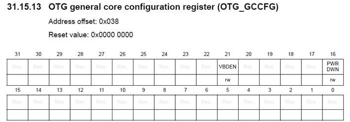

I tried to debug, but it seems there are some mistakes in the library and the datasheet.
1. Page 1140 of the Reference Manual of STM32F446, the register 'OTG_GCCFG' does not comply with the USB_OTG_GCCFG_TypeDef structure defined in usb_regs.h
2. In USB_OTG_GCCFG_TypeDef structure, the 'disablevbussensing' should be 'enablevbussensing' regarding the definition of register
OTG_GCCFG / bit 'VBDEN' => consequently, there are some mistakes in the library (setting 1 instead of 0 to 'disablevbussensing' variable)
3. In the Reference Manual, page 1100, it talks about the SOFOUTEN bit of OTG_GCCFG register, bit this bit is not defined regarding page 1140
However, if I try to 'fix' the possible msitakes, I don't manage to disable VBUS sensing feature.

Khouloud GARSI
Posted on May 30, 2017 at 15:05
Hi Vincent,
I confirm that there is a misalignment between the reference manual and the USB library.
I have highlighted this internally for review and I will get back to you with any update on this point ASAP.
Sorry for any inconvenience this may have caused.

Khouloud GARSI
Posted on June 01, 2017 at 13:45
Hi Vincent,
  • The STM32F446 MCUs are not completely supported using the STM32 SPL library.
    Enabling or disabling the VBUS sensing is not correctly managed.
    A new release of the library V2.2.1 will be available in coming weeks.
  • The project that you have previously sent does not use the PA9 pin (OTG_FS_VBUS). That's the reason no issue was detected from my side.

Khouloud GARSI
Posted on June 01, 2017 at 16:05
The related reference manual will be updated. The SOFOUTEN bit shouldn't have been mentioned.
The GCCFG register definition is correct.
Please, refer to the USB example found under the cube package. It's already tested using the STM32F446 device.
Khouloud.
Posted on June 01, 2017 at 15:31
Hi
garsi.khouloud
Thank you for your answer and for confirming the issue.
You didn't answer about a problem in the datasheet itself (not related to the library) :
What I need to do is to disable VBUS sensing because my PA9 pin is used for another purpose (USART).
But now that I know the library is incorrect, I'm still not sure if the datasheet is correct or not.
Based on what is written in the datasheet, I couldn't manage to disable VBUS sensing.
I'll have a look at STM32F4Cube to see how they do to disable VBUS, supposing this part is working.
Vincent.

Posted on June 02, 2017 at 16:50
I can't test STM32F4Cube example, but I had a look at the code.
The CustomHID example uses PA9 as VBUS sensing, and this is not what I want, I want PA9 as general purpose input.
Nevertheless, I looked deeper to see how the example handles the 'disable vbus sensing' feature, and I found that :
1. The USB register setup part is almost exactly the same as
STM32 SPL library
2. Line 220 and 221 of stm32f4xx_ll_usb.c writes the 'B-peripheral session valid override' bits of GOTGCTL to force a valid session, BUT this bits are said 'reserved' in the reference manual, when using USB FS. So this seems wrong again
3. Even if this seems wrong, I've tested enabling 'B-peripheral session valid ovveride', and still it is impossible to enable USB if you're using PA9 as standard input with 0V on it.
All this makes me think of a hardware issue within the STM32F446 itself.
