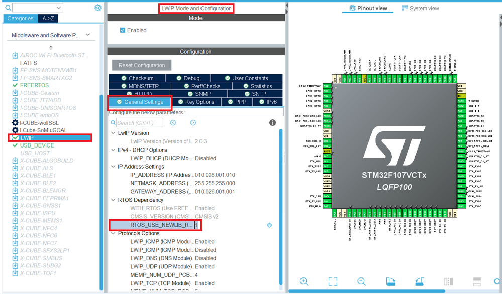

i use STM32F107+LWIP(2.0.3)+freeRTOS
I wrote the program with the help of the following document :
https://www.st.com/resource/en/user_manual/um1713-developing-applications-on-stm32cube-with-lwip-tcpip-stack-stmicroelectronics.pdf
After connecting the computer with the micro a few times, the information is correctly received by the micro.
But I don't send a reply to the computer. The tcp_server_recv callback function only turns one LED on and off for one second.
After sending information a few times, it stops receiving and I don't have ping anymore.
What advice can you give?

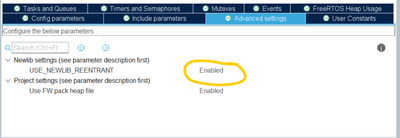

GO to freeRTOS-> Advanced Settings and Enable USE_NEWLIB_REENTRANT
This will fix the issue

Thanks for your reply. However, I already had this setting in FreeRTOS (Enable USE_NEWLIB_REENTRANT) and it was not the solution. A representative from ST helped out with this and the picture below explains the proper setup. The setting below in LWIP General Settings, must be set to "1" and this fixed the problem.
