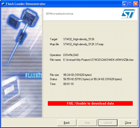

Posted on January 08, 2012 at 14:02
I am using PL2303 based USB to RS232 convertor. My Board has MAX3232 to USART1 interface. The ''ST Flash Loader Demonstration'' is working ok till last phase, where it fails after certain percentage of write. See the attached image ...

Posted on January 08, 2012 at 16:16
Well that will be fun to trouble-shoot.
It is possible that the flash memory is a problem, which could be due to power supply issues. Look at the bulk capacitance on the STM32, and those on the MAX3232.
Is the problem consistent across a number of boards? Different PCs or serial ports?
It could be a communication problem, serial data transmitted in this fashion can get corrupted. Try lower baud rates, and perhaps two stop bits. The protocol does provide for some simple checksum integrity check, but I can't speak to the robustness of the retries, or page erase/retry capabilities of the flash loader demonstration. Most of the failures are probably hard, and the diagnostic messages non-specific.
This might be easier to diagnose by using the command line source code, or reimplementing the protocol, so you can specifically identify if the problem is with transmission of data to the part, or the programming of data to the flash memory, or subsequent read-back verification.
avinash_elec
Posted on January 15, 2012 at 07:48
@Clive1
Thanks for your time.
actually my J-LINK died in middle of an important project. Since these are NOT available in by country, I have to import them via DHL Express. But it too take some time to get in here. I was trying to flash the board using bootloader instead of JTAG. Since I already had a neasrly debugged program with me.
Board may NOT be a problem (though I will check with other boards today). This is because I used 3-4 boards with my J-LINK and never faced any such verification problems. It was very reliable.
