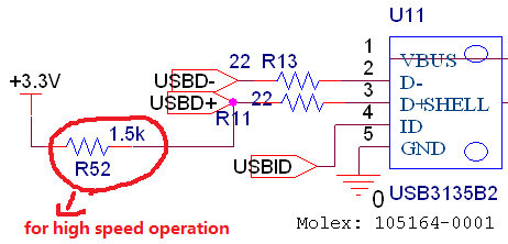

(1). PC doesn't response at all when you plug in the usb cable.
This is the most headache you may face. There are lots of possibility.
One of them is the missing pull-up resistor. You may need to connect a 1.5kohm pull up resistor.
The idea is the device needs to be correctly identified.
