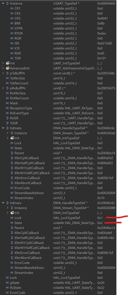

I'm doing Modbus communication using RS485. And using MAX485 IC to convert to RS485. and running on Free RTOS CMSIS.
I have tried and the behavior is random for all below, not consistent. Here I have tried with RS232 and it works like charm. The only issue with RS485. Where Modbus slave we have testing separately and it works fine too.
- Transmit and receive blocking call but seen packet drop during receive
- Transmit and receive interrupt with each byte and complete block of bytes, and saw complete frame is missing in reception.
- Transmit blocking and Receive using DMA, saw complete frame missing during reception.
- Transmit DMA and Receive DMA, saw receive frame is missing.
So lets continue discussion on DMA transmit and receive.
Here is the configuration for DMA and the USART2 is running at 16mhz
- Enable DMA for rx and tx and also enable rs485 hardware flow control, so that it can internally handle the DE pin.

void ModbusMaster::receive_(ModbusResponse &resp)
 __HAL_UART_ENABLE_IT(uart_, UART_IT_RTO);
    uart_->Instance->CR2 |= USART_CR2_RTOEN;
    HAL_UART_Receive_DMA(uart_, (uint8_t*)&resp, 7);
Here I was sending same type of query so the expected response will be 7 or in case of exception will get 5 so thats why use RTOR feature if no byte receive the generate RTOR error to exit the response.
void HAL_UART_RxCpltCallback(UART_HandleTypeDef *huart)
  //Verify response, if success then request for next query.
  //Here breakpoit here for wrong data or no data, and once breakpoint here it show hdmarx lock and busy, check the attache image below for uart details.
hdmarx lock and busy errorhdmarx lock and busy error
I have also tried to use
- HAL_UART_DMAStop(uart_); before request and after response to clear any flags,
- Clear buffer before use and after use
- Also tried to start receive dma before transmit, just to make sure I wont missed any bytes after transmit, but still same error in hdmarx.
- Tried to disable rs485 hardware flow control and make DE pin as simple output GPIO, and control during transmit and receive, but still same errors.
- I have read somewhere it may have issue with dma (D) cache, which I also tried to clear. like below, but still same issue.
- Before transmit --> SCB_CleanDCache_by_Addr((uint32_t*)frame, sizeof(frame));
- After receive --> SCB_InvalidateDCache_by_Addr((uint32_t*)resp, 7);
- Here DE pin is regulating at voltage 3 and the IC may need DE pin with voltage 5, does this may be the issue that it may not correctly toggling it?
Also just to be sure we have tried to keep same ground so that it should not create any issues.
Please help me out, I'm running out of my thoughts.

I'm not sure exactly why it was showing the lock before the HAL_UART_Receive_DMA() call. But the issue I observed from the slave side, which was not sending response to the master, and the master wait forever.
The lock may be because, the DMA waiting for big size buffer, and if the data not receive before x time then I do timeout and again initiate the transmit DMA, so their may be the case that, receive is not complete yet but due to timeout I do exit it forcefully which makes it lock that time.
Correct me, if my understanding is not correct.

Hello @npatil15
Please make sur that the buffer address and size are aligned to 32 bytes.
