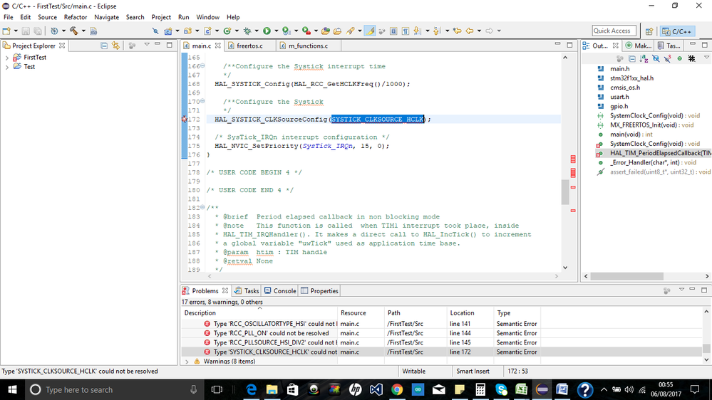

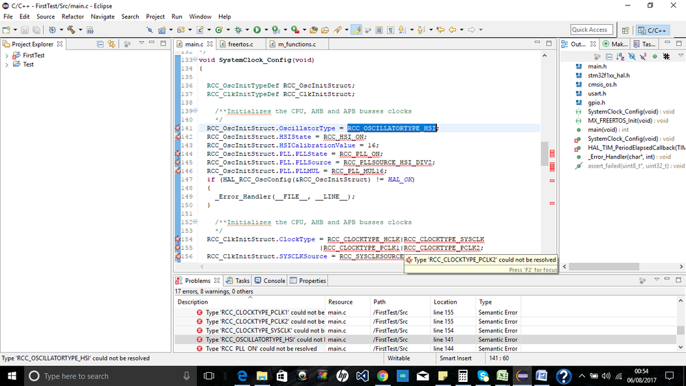

New to using ST for FreeRtos basic project.Created New Project following all steps in a course for getting started with FreeRTOS but ended up with bunch of errors. Can anybody help? Following are few Screenshots of the errors.

Hi Atif

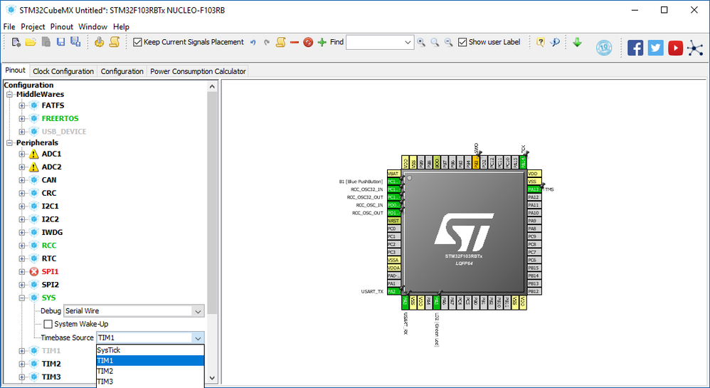

It seems you have a clock configuration problem.Could you tell me more about your project like what microcontroller/board you are using.If you have used CubeMX to create the project it is possible that you have forgotten certains steps.For example, Free RTOS require's you to use a different clock source for HAL_Tick,.Having more detail about the hardware you are using will greatly improve my ability to help you.
-Andy
Posted on August 07, 2017 at 20:45
Make sure you have the include paths set up correctly.
That you #include 'stm32f1xx.h'
That you have an stm32f1xx_hal_conf.h in your project and it correctly calls out and defines the modules needed.
That you have the define USE_HAL_DRIVER in the command line, along with the correct part selection.

The Board which I am using is: NUCLEO-F103RB (That is the only hardware I am using at the moment).
I did change the system clock as recommended.

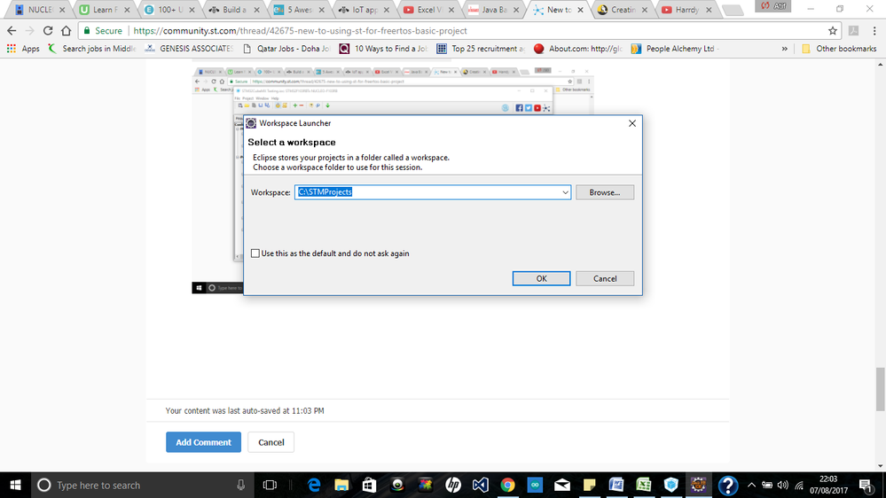

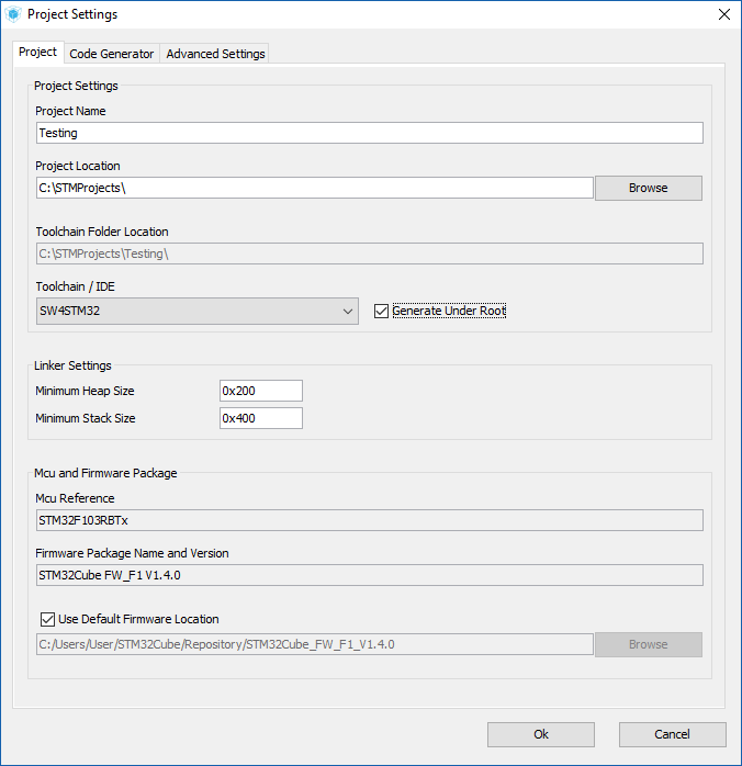

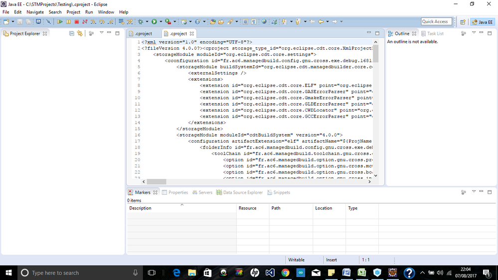

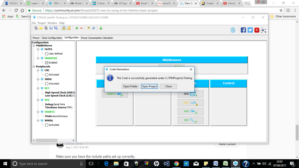

I did use STM32CubeMX but after I have created project then clicked on the auto generate code it opens up in my Eclipse but that is just a configuration file which opens then I imported that project into eclipse. May be that is why the issue is coming up?
If possible can you please help which steps should be followed. Much appreciated.
Posted on August 07, 2017 at 23:20
then
then step 3
and Selected OK
Step 4
Then Selected Generate Source code.
Step 5 ( Here something seems to go wrong)

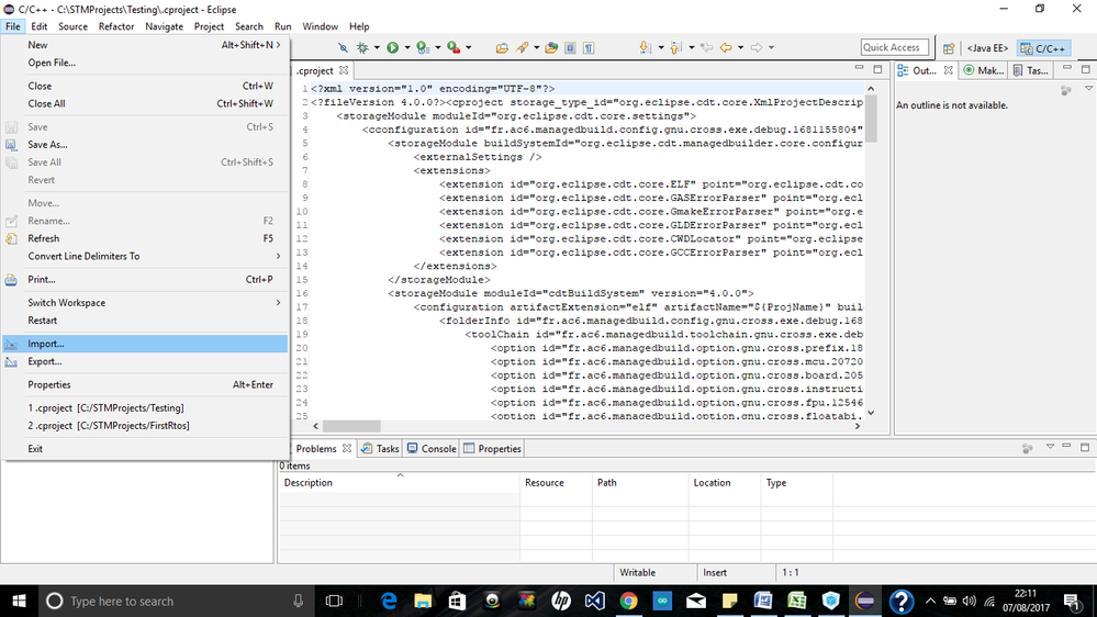

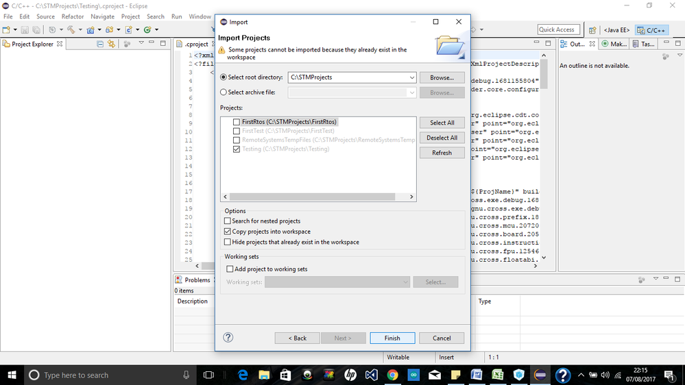

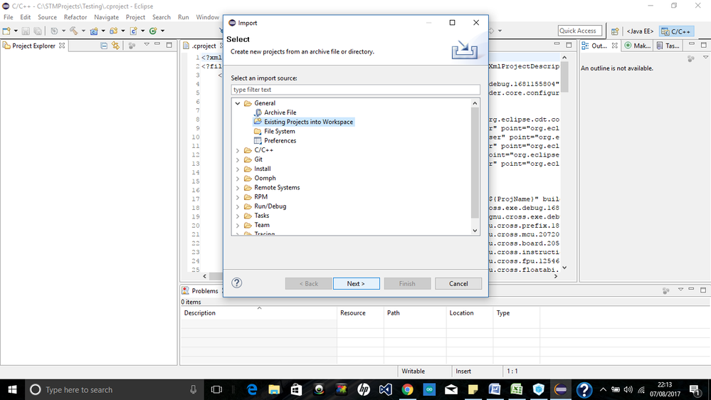

As that opened in Java based eclipse i also have C/C++ based eclipse which i have used in next step and imported my project into eclipse.

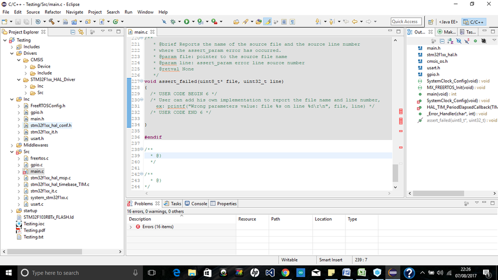

Rest is same as i posted earlier full of errors in main.C code.

I do have those files in the project inc directory. I believe all the aspects you have mentioned I have included.
