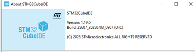

I am trying to set up  a UPD communication with a nucleo-H755ZI-Q board.
Now I have the effect, that the lwip stack sends out an arp request for its own IP address.
I double-checked the IP address and destination address to make sure they were correct.
Does anyone have any idea, what could be causing this?

Could you please provide more details, such as a screen capture of the Wireshark-captured frame and the CubeMX configuration for LwIP? The more information you provide, the less time it will take to find a solution.

The Address of STM32H755 (M7) is "192.168.0.1". (M4 ist not working)
The Destination-Address of the Pc ist "192.168.0.11".
Therefore in main.c:
IP_ADDR4(&PC_IPADDR, 192, 168, 0, 11);
udp_sendto(my_udp, udp_buffer, &PC_IPADDR, 55151);
Im am working with
Best regards,

Normally, if the gateway address is valid in the Wireshark capture, it means the device is performing an ARP probe to check whether the assigned IP address is already in use by another device. However, in this case, it appears your device fails to acquire the gateway IP address on its own, which explains the unusual 0.107.0.0 IP address. To resolve this, try setting the gateway IP manually and observe if the ARP traffic changes. Please get back to me if the issue persists so we can further analyze it.

I found the error. It was a simple transposed number.
For the LWIP_RAM_HEAP_POINTER i entered 0x30002000
instead of 0x30020000. Sorry.
The problem with the STM32H755 is that errors when setting up Ethernet are difficult to debug. You don't get an error message and
it's difficult to find the cause due to DMA usage.
There does not appear to be any official guide on how to set it up. Example projects either do not exist, are for a different MCU, do not have an .ioc file, cannot be installed, or use rtos.
