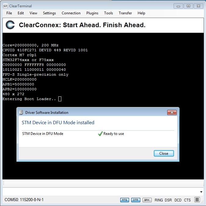

This brought up 'STM32 BOOTLOADER' on the STM32F746G-DISCO for me
void BootDFU(void)
  printf("Entering Boot Loader..\r\n");
  SCB_DisableDCache();
  *((unsigned long *)0x2004FFF0) = 0xDEADBEEF; // 320KB STM32F7xx
  __DSB();
  NVIC_SystemReset();

Clive1 (HNL)
