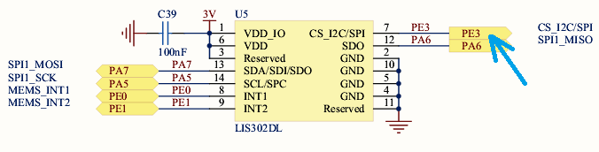

Dear Developers,
I wrote a program which is set to a low level of PE3 Pin. BOOT mode is switched to the next step when the PE3 Pin measured high levels.
This can cause serious problems in future developments. Therefore, I ask, why is this happening? Where to look, how to BOOT mode voltage levels in the Pins?
PE6 on what chip/board? How are you driving/setting it low? What does the code look like?
How does it get high? Is this your BOOT mode, of the System Loader via BOOT0/BOOT1 pins?
Can what cause problems?
So, if I understand, you set the pin LOW in software, and then externally you drive it HIGH? That would be a problem as you have TWO OUTPUT fighting. Why are you doing this?
Wouldn't the more reasonable solution be to use the pin as an INPUT? With a PULL DOWN resistor (Internal/External), and then switch that HIGH later.
Why is what happening?
I'm not sure I understand. Please describe the problem more clearly, use a schematic or diagram if that is helpful. You can attach PNG/JPEG using the ''Mountain/Sun'' icon. You can paste in code using the ''Paint Brush [<>]'' icon.

I will try to describe my problem.
We want to create a control with Cortex MCU. We do not know this controller, so we  purchased a developer board
http://www.st.com/st-web-ui/static/active/en/resource/technical/document/user_manual/DM00039084.pdf
. We will want in future own board planning, so we test this developer board.
A friend of mine has developed a STM32F1XX-type microcontroller. Made the HW, integrated environment, it worked normally. However, because development was literally in the meantime wanted to change the code so that crossed boot mode to re-program the MCU.
Then I set her in normal mode after reset the microcontroller low levels, refused to follow this boot mode, and turn an actuator on the controller.
Before we purchased from a developer development board
. I tested this problem.
I wrote a program that sets up the PE3 pin low (after reset is I/O pins). I measured by the multimeter to 0 volts  (I do not change to HW). Then turned it boot mode (BOOT0->VDD), and the PE3 pin looking with multimeter's. There was 2.94V.

Posted on July 03, 2013 at 16:48
I'm not sure of any reference to PE3 being used by the System Loader.
PE3 is connected to the CS_I2C/SPI pin of U5 (LIS302DL) on the STM32F4-Discovery board. The table suggests this is PE2, the schematic says otherwise, as does the demo software. ST might want to fix that.
 ''When no communication is on-going, data on CS, SPC, SDI and SDO are driven by internal pull-up resistors''
http://www.st.com/web/en/resource/technical/document/application_note/CD00167594.pdf
http://www.st.com/st-web-ui/static/active/en/resource/technical/document/datasheet/CD00135460.pdf
Table 5, Page 28 is WRONG wrt PE2 and PE3
Already aware of this issue reported in this [DEAD LINK /public/STe2ecommunities/mcu/Lists/cortex_mx_stm32/Flat.aspx?RootFolder=/public/STe2ecommunities/mcu/Lists/cortex_mx_stm32/STM32F4%20SPI%2c%20Weird%20signals%20on%20the%20MOSIMISO%20lines&FolderCTID=0x01200200770978C69A1141439FE559EB459D7580009C4E14902C3CDE46A77F0FFD06506F5B&currentviews=245]thread, it will be fixed in coming user manual revision.
