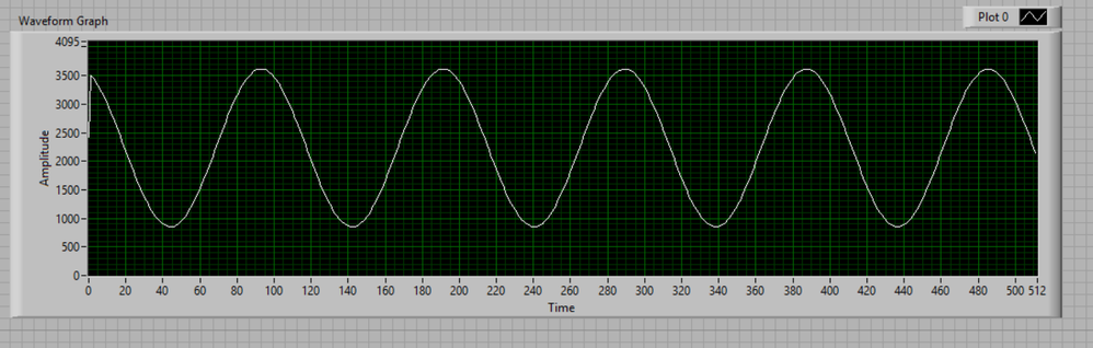

I am almost done. I have around 1MS/s with this code :
 while (1)
		for (int i=0;i<512;i++)
		  while ((ADC1->ISR & ADC_ISR_EOC) != ADC_ISR_EOC){}
      uint16_t val=ADC1->DR;
			ADC_buffer[2*i] = val  >> 8; // MSB
      ADC_buffer[2*i+1] = val & 0xFF; // LSB
  CDC_Transmit_FS(ADC_buffer,1024);
		HAL_Delay(1);
I've put a HAL_Delay after the CDC_Transmit and that has stabilized the strangeness of the bigibing.
here is a screen shot of a 10 kHz sine wave from a waveform generator :

What do you get if you read more than 512 bytes? is it smooth? The while loop is run every 1 msec while the USB FS standard shouldn't empty the buffer in a single transaction... Wondering if the CDC_Transmit is blocking...
https://www.beyondlogic.org/usbnutshell/usb4.shtml
