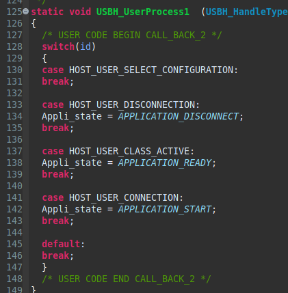

AScha.3
try to look with debug - break point : is Appli_state = APPLICATION_START; coming ?
 if not, big problem ! maybe hardware/wires wrong.
in usb_host.c :
0693W00000aH97OQAS.pngafaik app_ready is set, when device is ready . :)
means, after handshake ok and enumeration success ...
and try for first without DMA template . (i got it not working with DMA (caches ON) )
+ and also first test with D-cache off -- or if errors or not working
