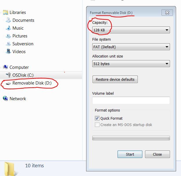

I am developing the application of USB Mass storage device using internal flash. I have used the ST CubeMx tool to generate the USB MSD code. I am using the last sector-7 (128KB) of MCU to create the Drive & i have modified the STORAGE_Write_FS() & STORAGE_Read_FS() functions to read and write from internal flash.
When i plugged In USB Device to PC, it created the flash drive in PC & the PC ask for formatting the drive first , but it is not able to format.

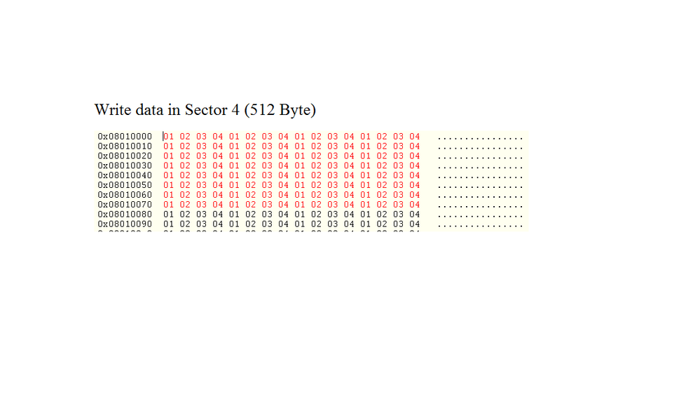

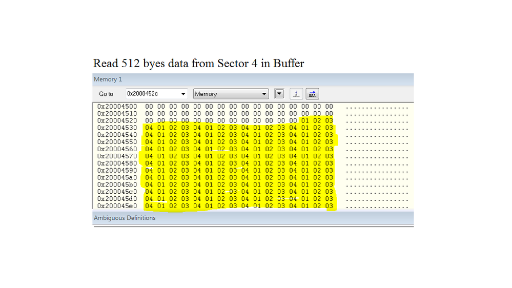

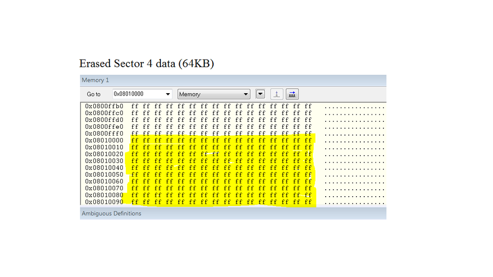

Thanks for the quick reply, as you said i have tested read ,write and erase functions it is working fine and also i have verified the data at flash memory locations it is also correct, i have used random data for testing. Previously i have used byte (8bit) read and write logic. Now i have changed it to WORD (32Bit) read & write logic and i am using sector 4 of flash to create drive, it is of 64KB. Below are the testing results...
Below are my flash read & write functions.....

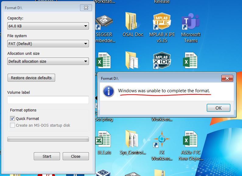

Below is the format error screenshot...
I have also tested this code using RAM memory it is working fine. But when i am using flash memory facing format issue...i am bit confused what to do now.
I have attached my code here, pls guide me where i am wrong....
