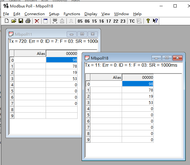

hello.
i was try to implement modbusTCP on STM32F7
my STM32F7 is modbus slave and my PC is modbus master for simulation.
it was work but have one question:
my modbus slave will store data to all slave(1-248), in normally, i should be store data to own slave only.
How to fix that?
i use freeRTOS to listen TCP

eMBErrorCode
eMBPoll( void )

 	//receive frame at ucMBFrame
 eStatus = peMBFrameReceiveCur( &ucRcvAddress, &ucMBFrame, &usLength );
 if( eStatus == MB_ENOERR )
 /* Check if the frame is for us. If not ignore the frame. */
 if( ( ucRcvAddress == ucMBAddress ) || ( ucRcvAddress == MB_ADDRESS_BROADCAST ) )
 ( void )xMBPortEventPost( EV_EXECUTE );
 break;
