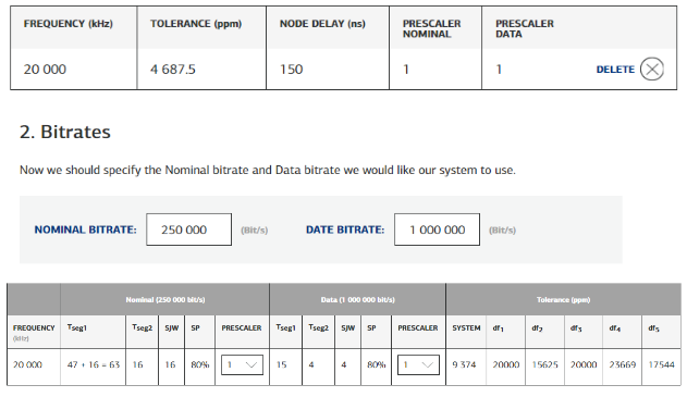

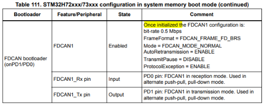

  • FDCAN bit rates are reflecting different from what is mentioned in the documentation
  • Documentation: bit rates = 0.5Mbps
  • Implementation: Nominal bit rate = 0.25Mbps / Data bit rate = 1Mbps
Questions:
  1. It was unclear whether the FDCAN peripheral needs to be configured as per the documentation or is already configured when the system enters boot mode?
  2. The bit parameters and the resultant bit rates of the boot mode FDCAN configuration is not matching. Could it be a documentation fault? If so, what are the correct values?

  • AN2606 says 500k, AN5405 says 250k/1M
  • stopping the core while running the bootloader confirms 250k/1M based on 20MHz clock

Replying to myself here.
from my other post here , the steps I took to get responses from the bootloader:
# configure the CANFD driver on Linux:
sudo ip link set can0 up type can bitrate 250000 sample-point 0.75 sjw 16 dbitrate 1000000 dsample-point 0.75 dsjw 4 fd on

 It is definitely 250k/1M, and I am suspecting that the sample window/jump settings are important (I have not yet tried without them explicitly set). I am also using the flag value of 1 which should set the Bit Rate Switch flag on the outgoing CAN frame.
The bootloader seems kind of picky and can hang/crash if it's tickled the wrong way.
