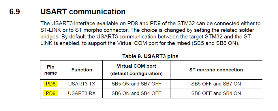

I want to enter the bootloader in system memory using the Nucleo-F429ZI but without success until now.
As I understood, the only thing to do to enter bootloader at reset is driving pin BOOT0 High and BOOT1 Low.
What I have tried is :
  • solder the SB152 in order to have BOOT1 pin pulled down
  • power the board, user leds start blinking (standard FW)
  • connect +3V3 and BOOT0 pin : the user leds stop blinking (I don't get why...)
  • reset the board, the user leds don't blink (but I'm not sure I'm in the bootloader though)
  • disconnect +3V3 and BOOT0 pin
  • use STM32CubeProgrammer to open an UART connection on the ST Link COM Port (115200 br with even parity) : failure to open connection - time out !
Is there something I'm missing ?
Any help much appreciated !

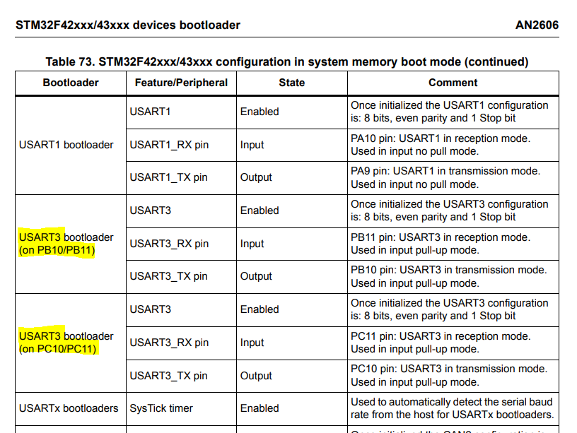

  • looking at the document AN2606 p 172, you can see that bootloader USART3 is only accessible through the pins PB10/11 or PC10/11
  • Meanwhile in the document UM1974 of the nucleo board, you can see page 26 that the virtual com port of the embedded ST-Link is connected to USART3 through the pins PD8/9

You cant use ST Link COM Port
Read AN2606 p172
