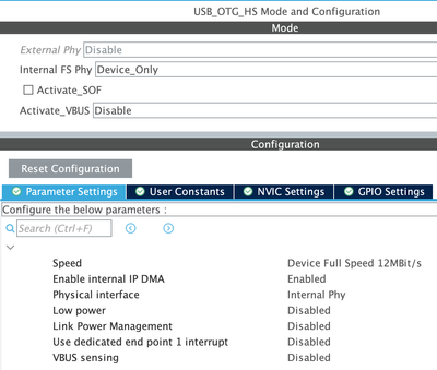

I have enabled USB with the following settings:

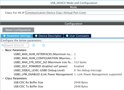

Following USB middleware is enabled like so:

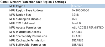

I also tried to enable MPU like so:
But that did not do the trick.
However, when RAM region base address (0x24000000) is used instead of RAM_D2 (0x30000000) for MPU, device enumerates correctly:
and there is no need for:
__attribute__((section(".dma_buffer")))
on rx and tx buffers anymore.
Now the question. How to correctly place only the USB related stuff to non-cacheable region so that rest of the application can work with cache enabled?
In summary, Currently I have disabled cache with MPU for entire region (RAM (xrw) : ORIGIN = 0x24000000, LENGTH = 128K). USB with DMA works, but it means that rest of the application also is experiencing disabled cache which is not what I want. I only want to disable cache for USB stuff. It is not enough just to place rx and tx buffers in non-cacheable region. From findings, it seems that also descriptors and potentially other stuff must ble placed in non-cacheable region as well.

I did check that post. That post gave me a hint that I have to move away from DTCM RAM which I did. That post only proves a point that DCache is the main culprit but does not lay down steps necessary to fully configure the entire project. I think the only thing left now is to correctly decorate USB related stuff with correct attributes, so that cacheable and non cacheable data can be separated. Now I have everything sitting in non cacheable are (set by MPU).

@FBL @AScha.3 I updated question in my original post. I think previously it was easy to misunderstand what actually I am looking for. Just to recap, I managed to enable USB with DMA and device enumerates correctly, but at the expense of placing everything to non-cacheable region (updated linker script to use region starting at 0x24000000 for everything instead of 0x20000000 which was the default). I only want to do this for USB related stuff. By just placing tx and rx buffers to non-cacheable area does not work. I think more stuff from USB HAL side must be placed to that area. I have no idea what and how to do the separation.
