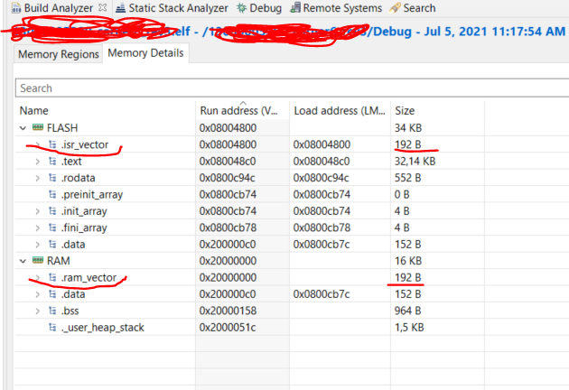

I developed my first canbus bootloader for a stm32f105.
Now im in need to use that same bootloader in a stm32f072.
The bootloader works but im unable to build a program that starts from a flash address other than 0x8000000.....
How are multi programm apps being programmes in stm32f0xx families?

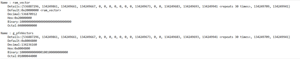

ram_vector looks like its corectly reserved by the linker at the beggining of ram0693W00000BcoAVQAZ.png
ram_vector also gets succesfully filled with the correct vectors

waclawek.jan
Hi Javier,
So, success?
Thanks for coming back with the solution.
Jan
yup, success as far as i know.
I still need to check a couple of things but programm executes, systick interruption works and nothing looks off.
