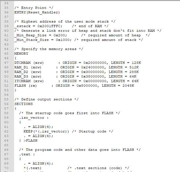

I'm trying to implement IAP to jump from bootloader to my application on stm32h743 target.
I m trying to use example code STM32H743-EVAL from ST without success.
I think, i set correctly both linker file, remmaping of VECT_TAB_OFFSET etc.
My question is, what should be the status of boot0 pin ? In my case, it is connected to ground.
Do you have any idea or suggest ?
Thank you
Samir
10 REPLIES 10
I am back and despite the change of linker script, there is no effect.
I dont understand why when i change end of RAM @0x2001FFFC, my APPLICATION_ADDRESS value is still stored @0x20020000 !
