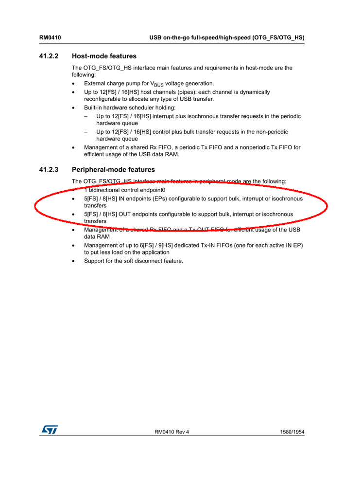

how many USB end Points Possible on STM32F767?
APate.8
I am trying to make composit USB example with MSC and 2 CDC.
Can anyone suggest if its possible with STM32F767VIHx ?

waclawek.jan
The number of endpoints depends on whether you are using OTG_FS or OTG_HS (regardless of the actual PHY/speed used).

APate.8
I have configured the application as MSC+ 2 CDC, so it uses total 5 IN end points and 3 OUT end points.
It populate correctly on windows and MSC works perfect.
However, 2 CDC are not working. They only works if I send messages from one port to another in loopback mode. (Receive Packet will forward the messages to opposite CDC).
I am using freertos and CubeMx to generate project code. If I send using CDC_Transmit_FS() function from freertos it doesnt work.
USB interrupt priority set to 7 while FreeRTOS LIB Priorities from 5 to 15.
Has anyone got the same issue?
