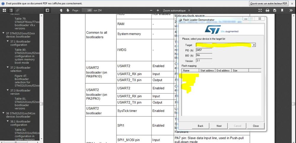

Hello everybody,
I would like to make my first program on the PCB that I have soldered with a STM32L011, but I can't upload my first program.
You can help me.
I am the instructions of this forum, but I have no boot1 on my STM32L011.
Http://www.scienceprog.com/flashing-programs-to-stm32-embedded-bootloader/
T
hank you very much
#bootloader #stm32l0 #boot0

Imen.D
Posted on March 02, 2017 at 20:43
Looked into
http://www.st.com/content/ccc/resource/technical/document/application_note/b9/9b/16/3a/12/1e/40/0c/CD00167594.pdf/files/CD00167594.pdf/jcr:content/translations/en.CD00167594.pdf
, chapter 37 'STM32L01xxx/02xxx devices bootloader', it will be helpfull for you.

Posted on March 03, 2017 at 10:18
Hello imen,
Thanks for your reply, but I have a problem with the Flash Loader Demonstrator software that gives me no target.
Attached is a more explicit photo.
Thank you very much.
Posted on March 03, 2017 at 10:42
Hi enedis.ibrahim,
Here is attached a newer version of theSTMFlashLoader Demonstrator 'STMFlashLoader Demo_V2.9.0RC4' adding support of new STM32L0xx devices.
Please try with this new versionand we hope you will continue to keep us informed about your updates, if it is working as expected or you faced any issue.
I would inform you that this new version ofSTMFlashLoader will be available as soon on the web.
Regards
Imen

Posted on March 07, 2017 at 14:36
Thank you so much, Imen

Posted on September 29, 2017 at 00:06
Thank you Imen for posting a link to the latest flash loader, it worked for me.
I'm working with an STM32L021, and finding it's bootloader operates differently than the STM32L052 bootloader that I got working 6 months ago.
i agree with Jules, this latest 2.9 flash loader should be up on the site.
