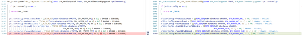

Searching a two days after problems when changing from CubeMX MCU package for F7 series from 1.17.2 to 1.17.3
Seems the same issue:

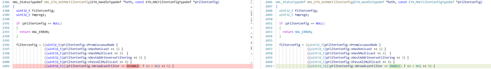

I have checked HAL_ETH_SetMACFilterConfig() against Reference Manuael RM0433 Rev.8. This function is correctly implemented: BroadcastFilter == ENABLE sets Bit5, which blocks all incoming broadcast packets.

BroadcastFilter == ENABLE means broadcasts are enabled - this is what everyone wants.
It is assigned to ENABLED in _nx_driver_hardware_initialize().
But @hansnaert possibly found a bug that resets this flag when the current filter is read.
The meaning of bit 5 is INVERSED: when 1 it blocks broadcasts:
(from STM32H7 RM)
So, with the bug, if the global FilterConfig in nx_stm32_eth_driver.c were modified by HAL_ETH_GetMACFilterConfig() - what I don't see there - then FilterConfig.BroadcastFilter would be cleared by mistake. Again, I don't see this bug in the current version of ETH driver.

@Pavel A., indeed, with the current version of the drivers it seems solved for the F7 series also.
