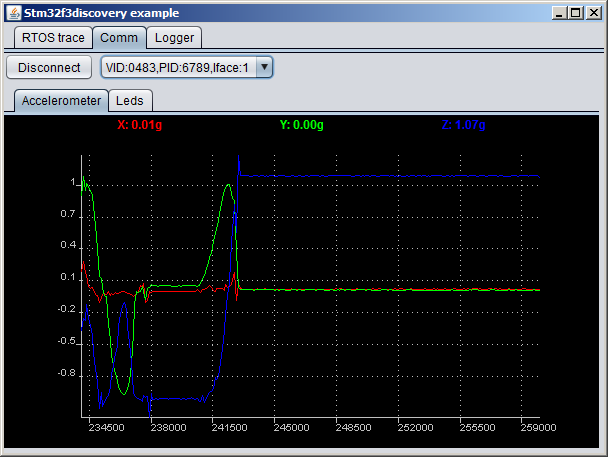

Posted on May 09, 2013 at 23:46
I just uploaded new binaries on the SF page. The new binaries improve the capabilities of the smt32f3discovery example. As shown on the image below it is now possible to plot the data coming from the on boards accelerometer with the PC application through USB.
Please check the SF wiki page (
http://sourceforge.net/p/embkernel/wiki/Home/
) for more information on how to run the examples.
