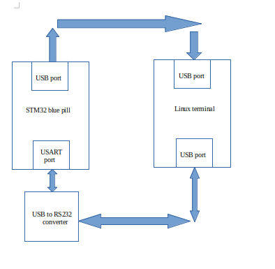

Block diagram of setupBlock diagram of setup
 Once you flash the program onto MCU, you can open Putty SSH client program for two instances i.e. USB virtual com port and USART com port. Message you type on the USART com port instance on Putty will be displayed on the USB virtual com port instance via DMA on the linux terminal.
