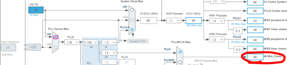

I'm working with an STM32F479VI on a custom PCB. I've already set the HSE_VALUE to the frequency of my external Osc. I've been told however, that in order to use HS_IN_FS I also need to configure the PLL. The readme.txt also says something about setting a "USBCLK" variable, which I can't find. Because of how the MCU is broken out on the custom PCB, I have to use pins PB14 and PB15, the USB_OTG_HS pins, for my USB interface.

#2 There are a lot of variables with "PLL" in them. Which ones do I set and where (I'm guessing in system_stm32f4xx.c)?
Run CubeMX with your chip for a good visualization of the clock scheme. You need to ensure the "48 MHz" clock is 48 MHz, which typically comes off of PLL1Q.
Typically clock settings are set in SystemClock_Config().
