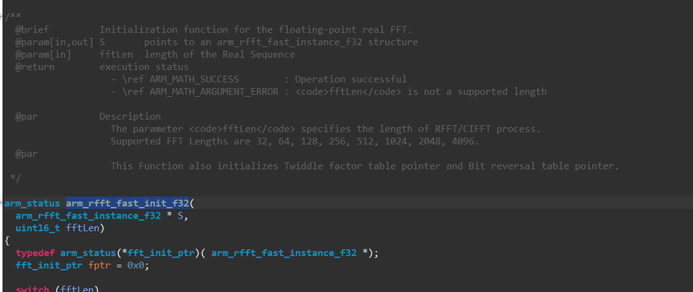

So maybe you didnt read , in arm_rfft_init_f32   :
>Supported FFT Lengths are 128, 512, 2048. <
Is your fft size > 2048 ?
Check your FFT settings with an calculated sine in the data array , to find out , whats wrong.
Im using a 1024 point FFT. It says here that this size is supported but i will do some other test and also do what you advised me.
